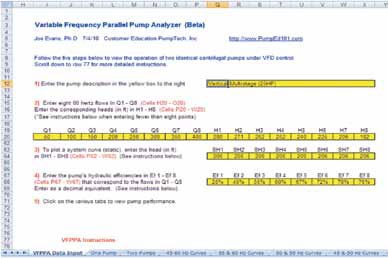

 VFPPA Data Input Tab
Figure 1. VFPPA Data Input Tab
Figure 1 is a screen shot of the data input tab of VFPPA Excel sheet. It shows the required data (yellow cells) and the tabs that are generated. The “One Pump” tab shows the H/Q curves and hydraulic efficiencies of a single pump at speeds of 45 to 60 Hz. The “Two Pumps” tab shows the same information for two pumps running at synchronous speeds. The other tabs show both single and two-pump operations at different speeds and are used if a more detailed view is required. The Average Efficiency Calculator and the Energy Savings Calculator normally seen at the right of the screen are shown in Figure 4 and will be discussed later.

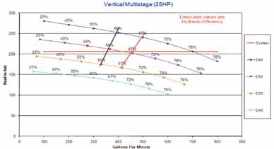

Plot produced by two pumps running at synchronous speeds
Figure 2. Plot produced by two pumps running at synchronous speeds
Figure 2 is the plot produced in the “Two Pumps” tab and shows the H/Q curves produced from 45 to 60 Hz under synchronous speed control. The data labels show the average hydraulic efficiency. As shown, when both pumps run at full speed (60 Hz), they produce a flow of 700 gpm at 206 ft TDH and operate at BEP efficiency (78 percent). The black angled line is the operating point of both pumps at single pump maximum flow (350 gpm). Speed is approximately 54 Hz and efficiency drops to slightly below 60 percent. As flow (speed) increases, so does the average efficiency of the two pumps. The red angled line crosses the system curve at 450 gpm at a speed of approximately 56 HZ, and efficiency is increased to about 67 percent. Let's take a look at individual speed control and compare the two operating efficiencies at 450 gpm.

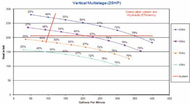

Figure 3 is the plot produced in the “One Pump” tab. As shown, a single pump operating at 60 Hz will produce a maximum flow of 350 gpm at 78 percent hydraulic efficiency. Under this control scheme, when the pump reaches maximum flow, it is maintained at full speed and the second pump is brought online at some reduced speed. The red angled line crosses the system curve at 100 gpm at a speed of about 52 Hz. This is the flow that must be provided by the second pump to match the 450 gpm flow produced by two pumps running at synchronous speeds. The hydraulic efficiency at this flow point is about 50 percent.
