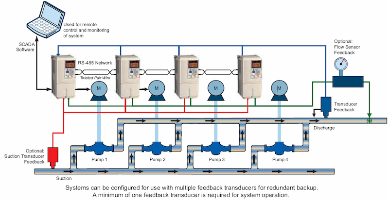

Figure 2. Four VFD multiplex pump system
Multiplexing VFDs
Multiplexing allows multiple VFDs to operate as a coordinated system, and it requires a high level of automation. If this automation is to be implemented via VFDs alone as opposed to VFD/PLC combos, advanced pump-specific VFDs are required. All the VFDs must be able to communicate over a digital network, and each VFD must be able to provide the required pump logic and PID control.
In the example shown in Figure 2, the multiplex pump system uses a transducer to sense line pressure. This transducer sends an analog 4-20mA signal proportional to pressure to one of the VFDs. Communications among the VFDs is via a simple Modbus RS-485 digital network in this example, although many networks are available to accomplish the required communications including Ethernet-based networks such as Ethernet/IP.
Required control and sequencing is configured through the VFDs, with communications among the VFDs via the digital network. The single pressure feedback signal is re-transmitted among the VFDs over the network, so only one feedback device is required no matter how many VFD/pump combinations are used.
However, multiplex systems typically use at least two feedback sensors configured in a redundant mode in case one sensor fails. Upon losing the primary feedback signal, the VFD will automatically switch to the other feedback signal, while simultaneously alerting the operator of the primary feedback signal's failure. As a result, the pump system will experience no interruptions.
Another level of redundancy is built into each of these pump-specific VFDs. If a VFD is currently running a pump and loses power or shuts off, the other idle VFDs will automatically come online as required to maintain system demand.
Advanced pump specific VFDs can be configured to operate in different ways in a multiplex system. In the Figure 2 example, when the lead VFD cannot maintain the demand of the system, it activates the lag units through the digital network. When this occurs, the most recently activated VFD becomes the lead and regulates its output frequency based on the feedback signal, while the former lead unit becomes a lag unit running at a fixed preset speed.
An alternate configuration would allow all the VFDs to regulate motor/pump speed based on the pressure feedback signal, ensuring that the pumps share the load equally. In typical operating conditions, this would result in all the motor/pumps running at the same speed. This would balance pump, motor and VFD wear and tear.
With this alternate configuration, as the demand decreases the running pumps will shut down one by one until a single pump is left running. If demand continues to reduce, the final pump can be configured to shut off.
Some advanced pump-specific VFDs have the capability of alternating which unit starts as the lead VFD based on lowest total run time, ensuring that each VFD/motor/pump will accumulate a roughly equivalent run time. Some pump-specific VFDs can also be configured to accommodate systems where a jockey or pressure maintenance is used to maintain the desired pressure in low demand conditions. More complex pump control capabilities available in some VFDs include pressure control using a secondary feedback for water level monitoring and regulation, suction level monitoring and/or regulation water level or suction pressure control and flow level monitoring.
