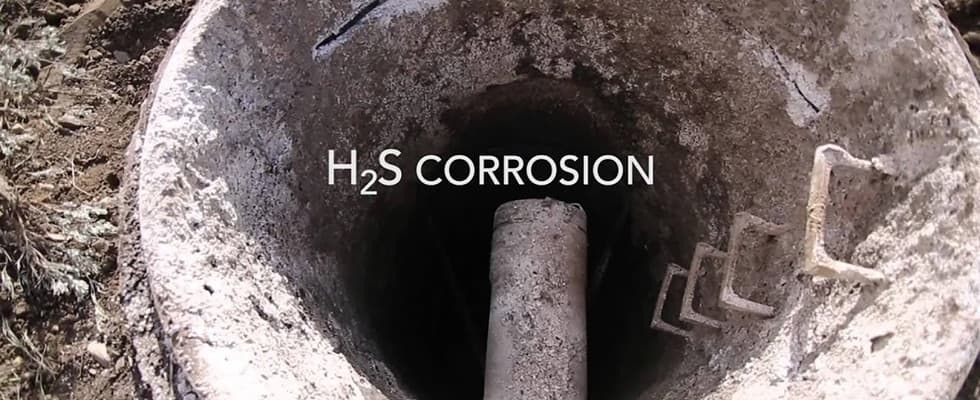

Corrosion Caused by H2S
A major contributor to odor and corrosion in industrial systems is hydrogen sulfide (H2S) and its associated compounds. Some industrial wastewater contains sulfur compounds, which provide the molecular basis for the generation of H2S. H2S arises from the combination of anaerobic conditions and the presence of sulfites and sulfates in conjunction with colonies of microorganisms present on the inner walls of all collection systems. This is referred to as the slime layer. Sulfate reducing bacteria (SRB) will use these compounds in the absence of free oxygen (O2) for metabolism. These bacteria do not use the sulfur component and are available to react with water, specifically free protons (H+), which results in the generation of H2S.
Following its generation, H2S can be released into the atmosphere and find its way to receptors through junctions of the atmosphere and collection system, thus becoming an odor concern. H2S is a colorless gas that has a characteristic rotten egg odor, is highly toxic and is corrosive to certain metals. It is heavier than air, meaning it can accumulate in wells, manholes and other similar locations that do not have much ventilation. The effect it can have on humans, at varying concentrations relative to ambient air, is shown in Image 1.
H2S health effects at different concentrations
Image 1: H2S health effects at different concentrations
H2S becomes a corrosion issue when it contacts moist concrete or steel (among other metals) in the presence of oxygen, even at low gaseous concentrations. Conditions such as these are common in the headspace of some pipes and other areas where the collection system has easy access to atmospheric oxygen. Bacteria in these areas converts the H2S into sulfuric acid, which then begins a destructive reaction with the infrastructure.
