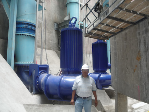

Figure 2. Pumps installed in La Caldera Pump Station

A similar design concept was applied on a second pumping station. The Caracol pump station is being constructed in the federal zone of the Texcoco Lake and is projected to discharge 40 cubic meters per second (m3/s) of combined sewage from the Tunnel Emisor Oriente to the Gran Canal open sewer channel. Twenty large submersible pumps will lift the fluid more than 40 meters. The pumps were supplied by a submersible motor pump company and are specially designed for heavy-duty wastewater applications.
In the La Caldera plant, eight of the 24 units (four per sump) supplied, handle a 1 m³/s of municipal sewage each, totaling the 8 m³/s that system designers consider to be the maximum dry-weather flow. Sixteen pumps with a capacity of 2 m³/s each were projected to join in operation during storm water flow, raising the total pump capacity to 40 m³/s.
In the Caracol pump station, each of the 20 units will pump 2 m³/s. The dry weather flow will be handled by four pumps per sump. Twelve units will take care of peak flows during the rainy season.
The pump design engineers faced several challenges. The huge medium-voltage motors had to develop up to 1,600 horsepower and still fit in the general series design concept. Moreover, the standard guide system for lowering and lifting the pumps in and out of the sump had to be adapted to site conditions.
