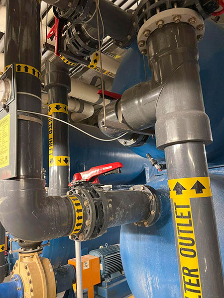

Application 1: Enhancing water filtration systems at Typhoon Lagoon
The application of thermoplastic valves at Typhoon Lagoon at Walt Disney World in Orlando, Florida, showcases the versatility and effectiveness of thermoplastic valves across various industries, particularly in environments prone to corrosion and chemical exposure. Over 20 years ago, Typhoon Lagoon originally relied on metal butterfly valves for their water filtration system; however, they faced issues with corrosion and reliability over time.
Upon inspection, it was evident many of the existing metal butterfly valves deteriorated due to corrosion, leading to ineffective filtration. To address this, a valve manufacturer introduced an 8-inch thermoplastic lug insert butterfly valve as a potential replacement. Customization was essential to ensure compatibility with the existing infrastructure, requiring longer shaft dimensions compared to standard valves.
Typhoon Lagoon’s interest in adopting thermoplastic valves highlights these valves’ growing recognition for benefits like durability and cost-effectiveness. This shift enhances the reliability and efficiency of their water filtration system and minimizes maintenance costs and downtime, ensuring a better experience for visitors.
Application 2: Improving life support systems at Mandalay Bay
Mandalay Bay Aquarium in Las Vegas, Nevada, renowned for its interactive shark reef exhibit, relies on sand filters for critical life support purposes to sustain water quality. However, they were experiencing constant leaks and corrosion issues with their existing stainless steel butterfly valves, which prompted the switch to thermoplastic 316 stainless steel lug inserted butterfly valves. The replacement process was straightforward, as the new valves served as a direct retrofit for the existing metallic ones, eliminating the need for spacers or re-piping. The decision to transition to thermoplastic valves has proven to be a lasting solution, as they withstand saltwater service, significantly reducing downtime and associated labor costs. Currently, they are still in operation without issues. Mandalay Bay’s experience emphasizes the effectiveness of thermoplastic valves in harsh environments, offering reliability and longevity crucial for sustaining critical life support systems.
