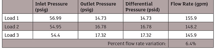

The inherent balance of the reverse return system can be shown when modeled in computer software and the systems are calculated. Let us first look at the pressure and flow distributions in the direct return system. Image 3 shows the direct return system with no controls on the loads and the pump sized for 450 gallons per minute (gpm), designed for 150 gpm through each identical load.
The inlet pressure to each load decreases the farther the load is from the pump discharge, and the outlet pressure of each load decreases the closer the load is to the pump suction. This creates a larger differential pressure at Load 1 and a decreasing differential pressure across each load the farther the branch is from the supply pump. This differential pressure profile causes the flow rate to decrease from 155.9 gpm at Load 1 to 145.9 gpm at Load 3, a 10 gpm (or 6.4 percent) variation from minimum to maximum flow rate. The pressures and flow rates are summarized in Table 1.
