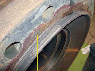

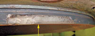

Best practice is to maintain stringent alignment and concentricity between interfacing parts. This ensures correct concentricity and perpendicularity between shaft and bearings and rotor to casing. The service center discovered that the top bowl male fit had been previously repaired by pad welding (see Figure 1), which is an improper practice due to the presence of a sealing O-ring. When a pad weld is performed on a pump that uses the O-ring design, fits and tolerances no longer meet acceptance criteria. It appears that the previous repair provider coated the faces with silicone or another sealant in an attempt to re-establish the proper fits or control leakage (see Figure 2).
 Pad welded male fit for the top bowl.
 Figure 1. Pad welded male fit for the top bowl.
Silicone coating appears to have been used in a previous repair after the male f
Figure 2. Silicone coating appears to have been used in a previous repair after the male fits were pad welded in an attempt to seal the proper fit between the top bowl and the discharge head.

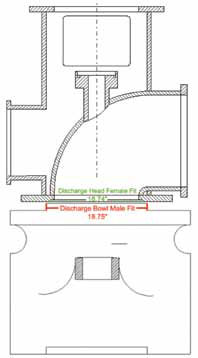

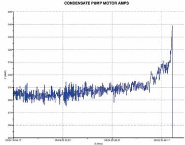

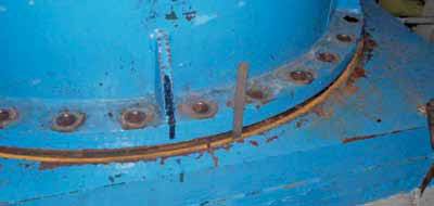

The top of the discharge bowl did not fit properly in the bottom of the discharge head (see Figure 3). Excessive force used to make these components fit bent the shaft and created a condition ripe for fatigue failure. The forced bending of the shaft caused the impeller ring to contact the case (bowl) ring during operation (see Figures 5 and 6). The motor had to produce more torque to drive the assembly due to frictional resistance from the heavy rub (see Figure 7). Furthermore, the suction bell was not properly seated in the alignment ring (see Figure 8).

The male fit of the top discharge bowl was over size at 18.754 in. and the femal
Figure 3. The male fit of the top discharge bowl was over size at 18.754 in. and the female fit of the discharge head was 18.7445 in., causing an interference fit (Exaggerated diagram, not to scale).
The bolts between the can flange and the discharge head appear to have been tigh
Figure 4. The bolts between the can flange and the discharge head appear to have been tightened with additional force as one section of the flange rose up about ¾ in. on one side after the discharge flange was unbolted from the base-plate.

 The high amps reading at pump failure show motor torque.
Figure 7. The high amps reading at pump failure show motor torque.
