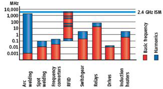

Figure 1 (below). A typical interfernece generated by equipment commonly found in industrial applications.  The 2.4 GHz band is higher than most interference produced by operating equipment, making it an ideal frequency for industrial applications.
Typical interference generated by equipment found in industrial applicationsThree different classes of radios are available for use in industrial settings.

Wireless Bluetooth devices operate in the unlicensed 2.4 GHz ISM frequency band. Set aside for industrial, scientific and medical (ISM) devices, the band is available for use in most countries. Its high frequency makes it ideal for industrial communications.  Equipment operating on plant floors generates base frequencies that could interfere with wireless communications. However, they will likely operate at lower frequencies.

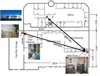

 Test system layout
Figure 2. Test system layout

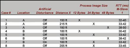

Case results
Figure 3. Case results

Identical nodes were used in the testing to simulate controller-to-controller coordination. Each node contained an Ethernet TCP/IP programmable Fieldbus controller, a digital input and output module and the Bluetooth module.
For the test, Slave 1 was placed in the plant's utility room—where a source of electrical noise could be activated—with Master 1 in open areas at varying distances away. Later, Slave 1 was relocated across the plant floor behind a wall near an automated parts retrieval system. After these trials, Slave 1 was placed in an office area behind an elevator and the test program was repeated. See Figures 2 and 4
Round Trip Time Program
A program was created to measure the efficiency of the Bluetooth modules. It measured the length of time taken to transmit data from the master to the slave and then receive it back.
For each slave, the master sent out the system time at the start of transmission. Meanwhile, the slave continuously returned the same process image that it received. The master watched these incoming packets, and when it detected the time value equivalent to the one it sent out, it recorded the new system time. The round trip time was calculated from the difference between the two system times.
Signal Strength
The capability of measuring the Bluetooth signal strength was available through the Bluetooth module's configuration software. Nominal signal strength registered at 0 dB. Typical values ranged from 0 to 4dB. During tests, that weakened the signal because of long distance and obstructions, values between 8 dB and 15 dB were observed but did not have a debilitating effect on the system. The most influential aspect of this value was clearly the distance between the nodes.
Bit Error Rate
The bit error rate signifies what percentage of transmitted data was lost due to interference or corrupted packets. These diagnostics were also provided via the Bluetooth module configuration software. When packets are lost, they are retransmitted, thereby increasing the round trip time. Findings showed that the process image size (and therefore packet size) of the Bluetooth module and certain obstructions had the greatest effect on this.
Sources of Interference
Overall, the Bluetooth modules with attached antennae appeared adequately resilient to noise and other sources of interference. A variety of attempts were made to degrade the signal under otherwise normal operating conditions, but in each case, the transmission remained reliable. These attempts and sources included an industrial compressor, a two-cycle gas engine and a variable frequency drive (VFD). The only scenario in which data became difficult to receive involved several walls, an elevator and a fair distance between the two nodes. In that test, the signal strength was greater than 20 dB, and the bit error rate exceeded 25 percent. Further testing for the exact cause was inconclusive.
Node locations
Figure 4. Node locations
