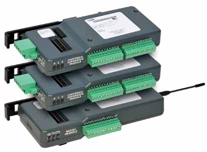

I/O Expansion
When considering wireless I/O for cathodic protection remote monitoring, understanding how I/O expansion might be an optimal choice is also important. An I/O expansion module offers a scalable solution to meet the demands of an operator’s automation requirements. It can be stacked on an applicable I/O radio or can serve as expandable remote I/O modules through a serial connection. Some pipelines run closely or parallel to each other. By synchronizing cathodic protection mechanisms and timing for all the pipeline measurements, an operator can effectively protect and manage locations in which multiple pipelines run in close proximity.
 I/O expanion module
If multiple pipelines are near each other and two to three of them are protected with rectifiers, each will have its own current going through the soil. Due to the proximity of the currents, they can interfere with pipe-to-soil readings. For example, to obtain a true measurement of an individual pipeline, its rectifier must be turned off. If the rectifiers for nearby pipelines are turned on during the measurement, the data could reveal a false positive indicating that the pipeline is protected. The reality, however, could be that the monitoring device was picking up the current from a different pipeline, and the pipeline in question could be worse than the measurement indicates.
To avoid this interference during monitoring, all other cathodic protection rectifiers in the area must be turned off to get the true reading of the pipeline. I/O expansion can help automate this process. It essentially groups all the controls for multiple pipelines with a single communications link (a radio base), automates those controls through one radio link and gets all the I/O points for multiple rectifier stations through one link (the operator can send additional I/O points to the expansion modules). The result is a single wireless link that can issue commands to a single device, allowing for the rectifiers to turn off and on as scheduled and for accurate data transmission.
