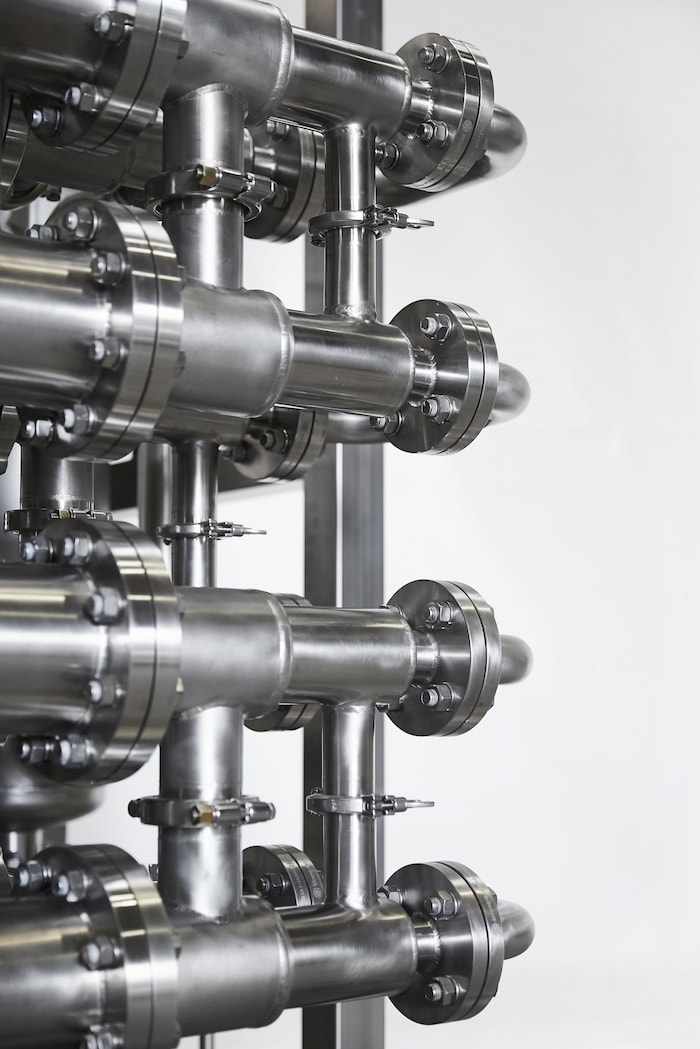

Tubular heat exchangers consist of different combinations of tubes within tubes and come in different forms, including those with corrugated tubes. Corrugated tubes increase product turbulence compared to smooth tubes (which are more common). This prevents fouling and improves operating efficiency. Corrugated tube heat exchangers are ideal for products with medium viscosity or containing small particles in suspension, such as creams, sauces, etc. As materials become more viscous in nature, tube-in-tube or annular space designs may be a better fit.
%20are%20designed%20for%20more%20viscous%20materials.jpg)
For high fouling materials and viscous fluids—or those containing large particles such as fruit pieces—scraped surface heat exchangers (SSHEs) may be the best choice. Different designs, such as reciprocating or rotary versions, provide options in terms of gentle handling (to maintain product integrity for creams or thick sauces, for example) or thorough mixing (for mechanically deboned meat, jams, etc.) while maximizing operating efficiency and uptime.

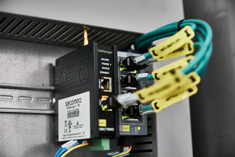

Also, what role does the heat exchanger manufacturer play in installation and commissioning? What training is provided for operators and engineering staff? Is equipment fitted with remote access and monitoring systems so the manufacturer can access key information and metrics and, when necessary, log on and discover any potential issues and quickly identify their resolution?
