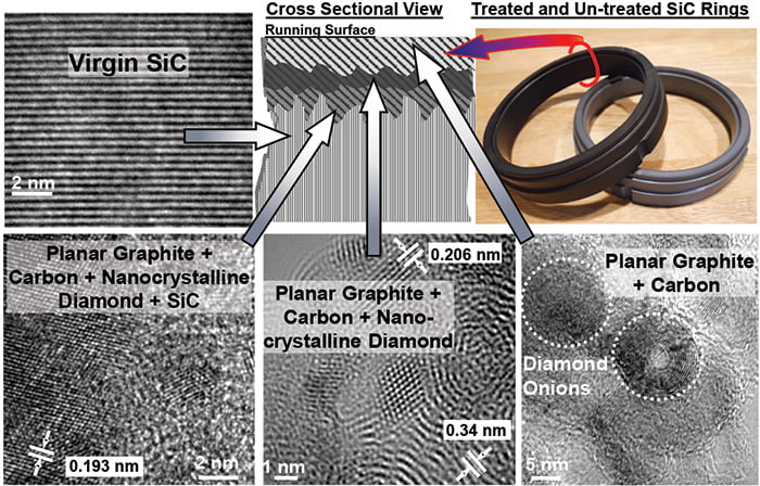

Carbon samplesFigure 1. Conversion of silicon carbide surface results in a matrix of carbon nanospecies that progressively increases in hardness with depth (Courtesy of Carbide Derivative Technologies)

What is needed is a seal surface that is robust in both its wear life and ability to survive flashing, dry running or edge running conditions due to pressure upset. That would cover all the bases, resulting in increasing system mean time between maintenance (MTBM) and mean time between failures (MTBF) without resorting to complex and expensive mechanical seal support systems. Such a surface was described in the article “Surface Conversion for Dry Running Performance” (Pumps & Systems, June 2009, read it here), a functionally graded surface composed of various carbon nanospecies derived from silicon carbide (see Figure 1). The gradation went from the self-lubricating planar graphite in the upper zones to harder nanodiamond zones deeper into the surface near the zone where it mixes with the virgin silicon carbide. The result is a hard running surface that also contains self-lubricating graphite. The self-lubricating graphite enables dry running, supported by hard underlying zones, which enable long wear-life and provide improved MTBM and MTBF under all operating conditions. Because the carbon nanospecies of this new surface are synthesized from the carbon contained in the silicon carbide, it is not a coating; it shares the silicon carbide microstructure. The carbon nanospecies and the silicon carbide are covalently bonded at the atomic level thus not able to delaminate, which nullifies that risk. Since the conversion process does not affect dimension or strength, no re-engineering is necessary when applying this technique. Treated mechanical seal rings are drop-in replacements for existing rings made of silicon carbide, tungsten carbide, carbon or alumina.
