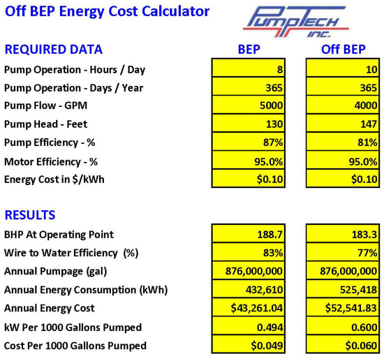

Although the pump and motor affect the overall efficiency, piping systems can have a greater influence. Poorly designed piping systems often require increased head, which translates into increased horsepower. Older piping is also problematic. Friction increases over time due to corrosion and build up, and increased demand will over tax the original design capability. The starting point is always the system curve, which shows the required pump performance (head and flow). When pumps run to the left of BEP, they will run longer at a lower efficiency, and energy costs can increase.
Another seminar example is shown in Figure 1. This spreadsheet compares the same pump and motor when operating at and off BEP conditions. The example included shows a pump system that was designed for 5,000 gallons per minute at 130 feet. Due to a design error, friction was miscalculated. The actual flow is limited to a maximum of 4,000 gallons per minute at 147 feet. To meet the required daily flow, the pump must run two more hours each day. It  also operates at a lower hydraulic efficiency, and the head required is higher. These last two factors increase energy consumption and result in an increased cost per 1,000 gallons pumped ($0.06 versus $0.049).
What are the options? The most obvious fix would be to modify the piping and get the pump to BEP flow. If this is not cost-effective, a smaller pump with a better efficiency should be selected. An increase in efficiency from 81 to 85 percent at 4,000 gallons per minute would reduce the cost per 1,000 gallons to $0.057 and save almost $2,500 per year in electrical costs.
A more efficient fix would be to select a pump with a BEP flow that reduces the system head to its original calculated val-ue—about 3,000 gallons per minute at 130 feet, for example. Although the pump would run several hours longer than the one pumping 4,000 gallons per minute, the energy costs would be close to the original 5,000 gallons per minute estimates.
