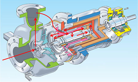

These pumps are 178-horsepower (hp) sealless magnetic drive pumps with a rated flow of 294 gallons per minute (gpm) and total differential head of 638 feet (ft). The process fluid is totally contained inside the pump containment shell and depended on to remove the generated heat through internal lubrication paths.

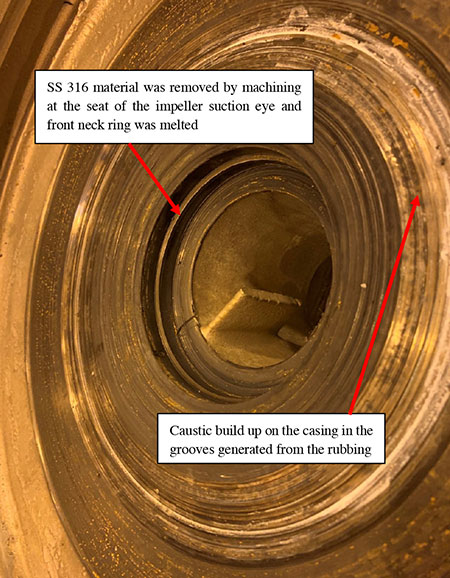

Therefore, any slight restriction to the lubrication flow paths will jeopardize the condition of the pump’s internal parts, resulting in catastrophic failure. Additionally, the fluid runs between the inner magnet, the containment shell and through the shaft holes to the rear of the pump shaft where it returns to the pump’s suction through the thrust balance hole in the impeller (Image 3). The pump shaft that is connected to the inner magnet is rotated by the action of the magnetic flux circuit between the inner and outer magnet. The outer magnet is coupled to the driver motor through another shaft to transmit the rotation to the inner magnet.

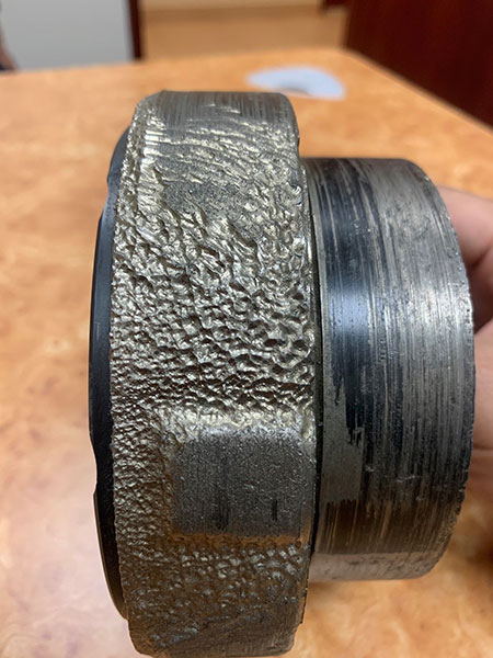

The decision was to remove the pump for dismantling and internal inspection. The major findings include:

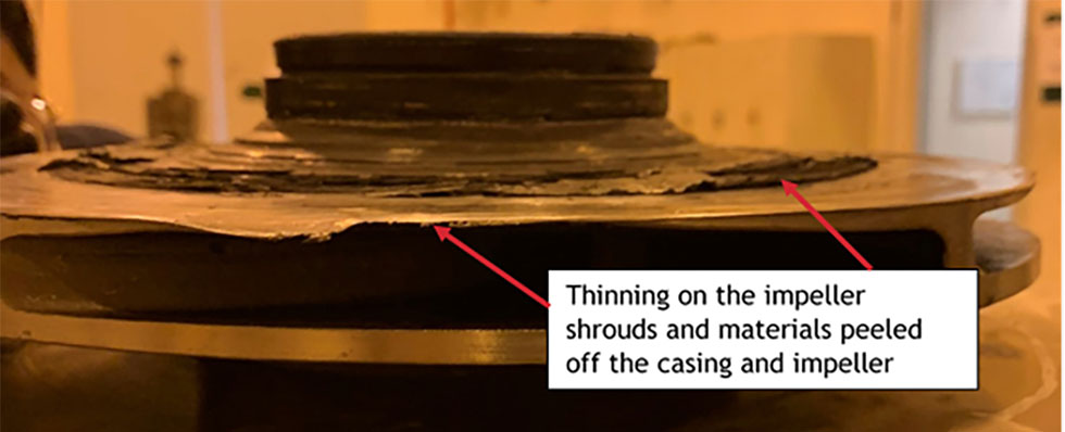

- There was excessive rubbing between the impeller front cover and the pump casing. Also, there was thinning on the impeller shrouds. This is an indication of high thrust movement as shown in Images 1 and 4.

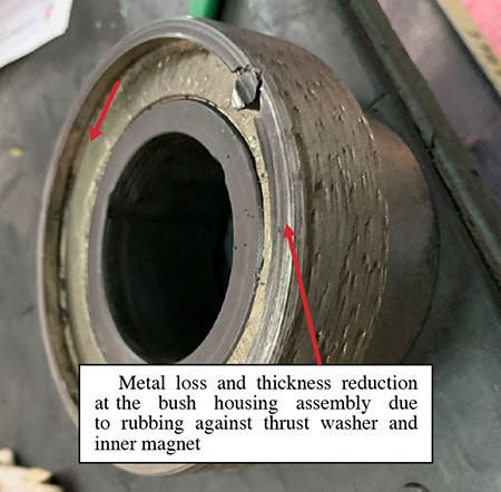

- Rear thrust pad, thrust washer and sleeve bush were not found in place. The silicon carbide bearings had failed and its traces were found inside the pump casing (Images 2, 5 and 6).

As shown in Image 6, it is suspected that the corrosion and loss of the titanium sleeve bush circumferential were enough to allow the bolts to lose the grip between the bush carrier and holder. Hence, all the bush carriers became free to move radially and axially, leading to thrust pad and thrust washer silicon carbide to shatter. The failure of the rear thrust pad and thrust washer (active bearing) increased the negative thrusting and axial movement of the whole rotor toward the pump casing. This resulted in heavy wear on the casing, impeller and radial bush failure.
