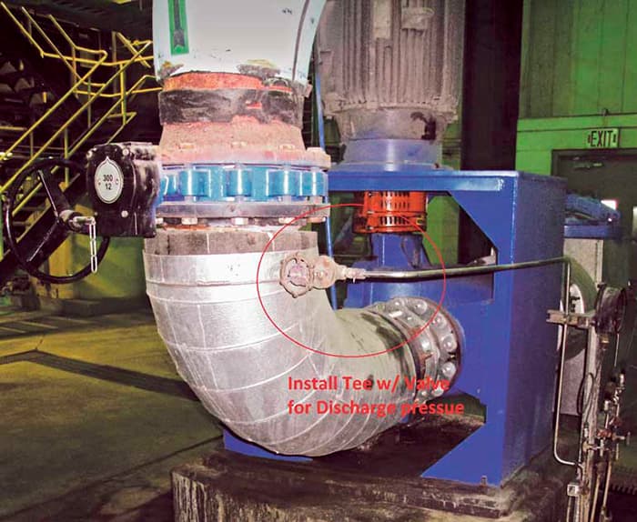

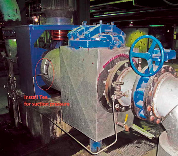

Images 1. Suction and discharge piping (Images courtesy of the author)
Images 2. Suction and discharge piping (Images courtesy of the author)

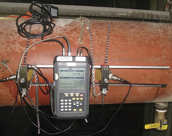

Images 3. Location of the ultrasonic flow meters
Images 4. Location of the ultrasonic flow meters
Pressures
Transducers were then connected to quarter-inch tabs teed-off the existing pressure gauge connections (see Images 1 and 2).Flow
The team tried three ultrasonic flow meters:- Dynasonic D902 (Doppler type)
- Dynasonic DXNP-RW (combination type, with both Doppler and transient time probes)
- GE 878 (transient time)
