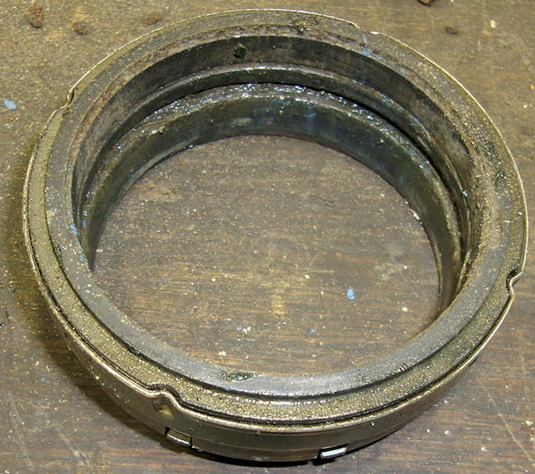

![Drive-end seal](/sites/default/files/0217/DE-Seal-5.jpg)
![Drive-end seal](/sites/default/files/0217/DE-Seal-3.jpg)
- Verify proper fit between the elastomer and the shaft and determine the cause of excessive interference.
- Provide proper venting to eliminate air pocket at the seal area during startup.
- Use hard-to-hard seal configuration to resist any particulate that might enter with cooling water.
- Rebuild the pump with these modifications and monitor its performance.
