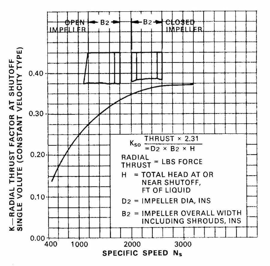

Figure 1. Radial thrust factor at shutoff for single-volute (constant-velocity) pumps (From Reference 3. Courtesy of the Hydraulic Institute, www.pumps.org, Parsippany, N.J.)
Hydraulic Institute Curve
In 1969, the Hydraulic Institute (HI) published a curve showing K values at shut-off for single-volute pumps as a function of specific speed [3] (see Figure 1). Although the HI values agreed with Agostinelli [2] in the higher specific speed range (around 3,000), they were almost twice the Agostinelli values in the lower range (around 600). The current HI K value graph, as seen in Figure 2, shows shut-off K values lower than the 1969 graph, and which compare favorably with Agostinelli [2]. The procedure continued to consider the effective area to be D2 x B2.

ANSI Specification B73.2 [4] (partially written by this author) required that the calculated shaft deflection not exceed 2 mills at the gland end of the stuffing box, under maximum radial load. Questions had been raised about a 3 x 2 x 11 single-volute pump, running at 3,500 rpm. To minimize the radial thrust, the impeller exit width (B2), at the 11-inch (maximum) diameter, had been designed at 3/16 inch. The D2 x B2 area (see Figure 4) was, therefore, 2.06 square inches. The shut-off head of 480 feet created a differential pressure, on cool water, of about 208 psi. Specific speed was about 650.  Using K = 0.18, from Figure 1, the calculated radial thrust was 77 pounds. With the appropriate motor, the 77 pounds would produce a shaft deflection, just above the mechanical seal, of an acceptable 2 mils. But two competitors reported that measured shaft deflection was considerably higher. It was necessary that we measure the radial shaft deflections.
Our test procedure was similar to that used by Stepanoff [1]. A rigid steel table was fabricated, to which was bolted a motor-coupling-shaft assembly. The shaft position—one-half inch above the location of the seal faces—was measured by a pair of proximity probes, located at right angles. Force gages were used to pull on the end of the shaft (at the location of the impeller) to establish an accurate relation between the radial force at the impeller and shaft deflection, ½ inch above the seal faces. We were able to accurately “calibrate” the motor-coupling-shaft assembly, even including the effect of looseness in the bearings.
When the pump was tested, we learned that the radial thrust imposed on the 11-inch impeller, at shut-off, was 240 pounds, more than three times the value calculated using the information in Figure 1—almost six times the value calculated using K values from the other references. Instead of using just the projected area of the impeller discharge, as illustrated in Figure 4, if we use the total projected area of the impeller, from the 3-inch diameter eye to the 11-inch outside diameter, D2, (see Figure 5) the area changes from the 2.06 calculated above, to 6.56 square inches.
Multiplying that by the 208 psi and by the 0.18 K value from Figure 1, results in a calculated radial thrust of 246 pounds, which is only 2 percent above the measured 240 pounds. The closeness of the agreement indicates that we should consider using this procedure for impellers that get wider as the diameter is reduced (and it may well work for all impellers). More sizes of pumps should be tested to determine if this concept applies to all sizes.
