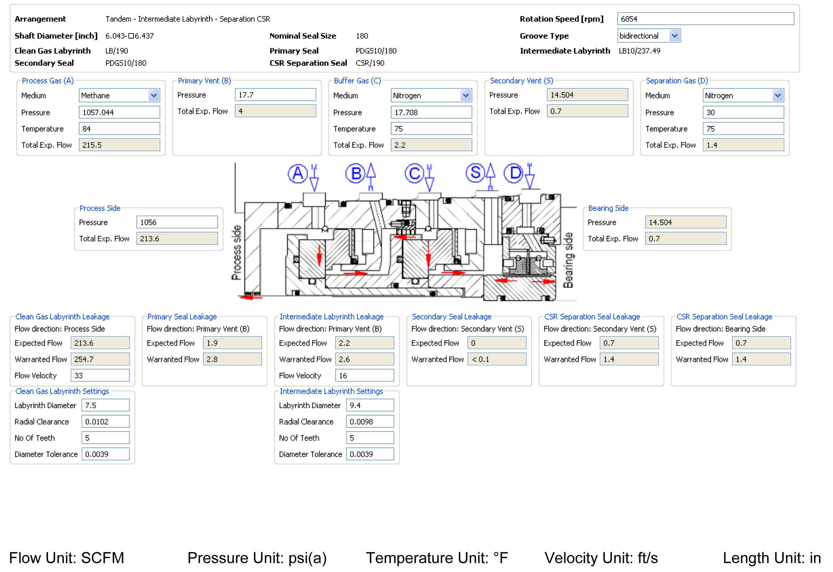

The next concern is monitoring the dry gas seal’s health. The seal health is monitored by seal leakage, which is defined as the amount of gas passing between the seal faces. Seal leakage will change based on the seal’s size, speed, operating pressure, operating temperature, and gas composition. A port in the compressor either vents the leaking gas to a flare line or a vapor recovery system, or routes it to a safe location and releases it to the atmosphere. A flow measurement device assesses the seal leakage as the gas flows through the vent line. An increase in vent line flow results from an increase in leakage between the seal faces, indicating a problem with the seal. When the flow rises to a level 2.5 to 5 times normal leakage, an alarm will notify the operator the seal is failing. Should the seal leakage increase 5 to 10 times normal levels, seal failure will occur, and a compressor shutdown and venting will be initiated.
The primary and secondary seals have different operating conditions; therefore, the primary seal leakage will be different than the secondary seal leakage. When purchasing a dry gas seal, guaranteed leakages (see Figure 1) are provided for both the primary and secondary seal. This information helps with designing the leakage monitoring system and identifying a primary seal failure. By knowing the identified leakage and where the primary vent line will be connected, a system can be set up to effectively measure the primary seal leakage.
This chart shows seal leakage calculations, based on operating conditions, which
Figure 1. This chart shows seal leakage calculations, based on operating conditions, which are necessary for designing an effective leakage monitoring system.

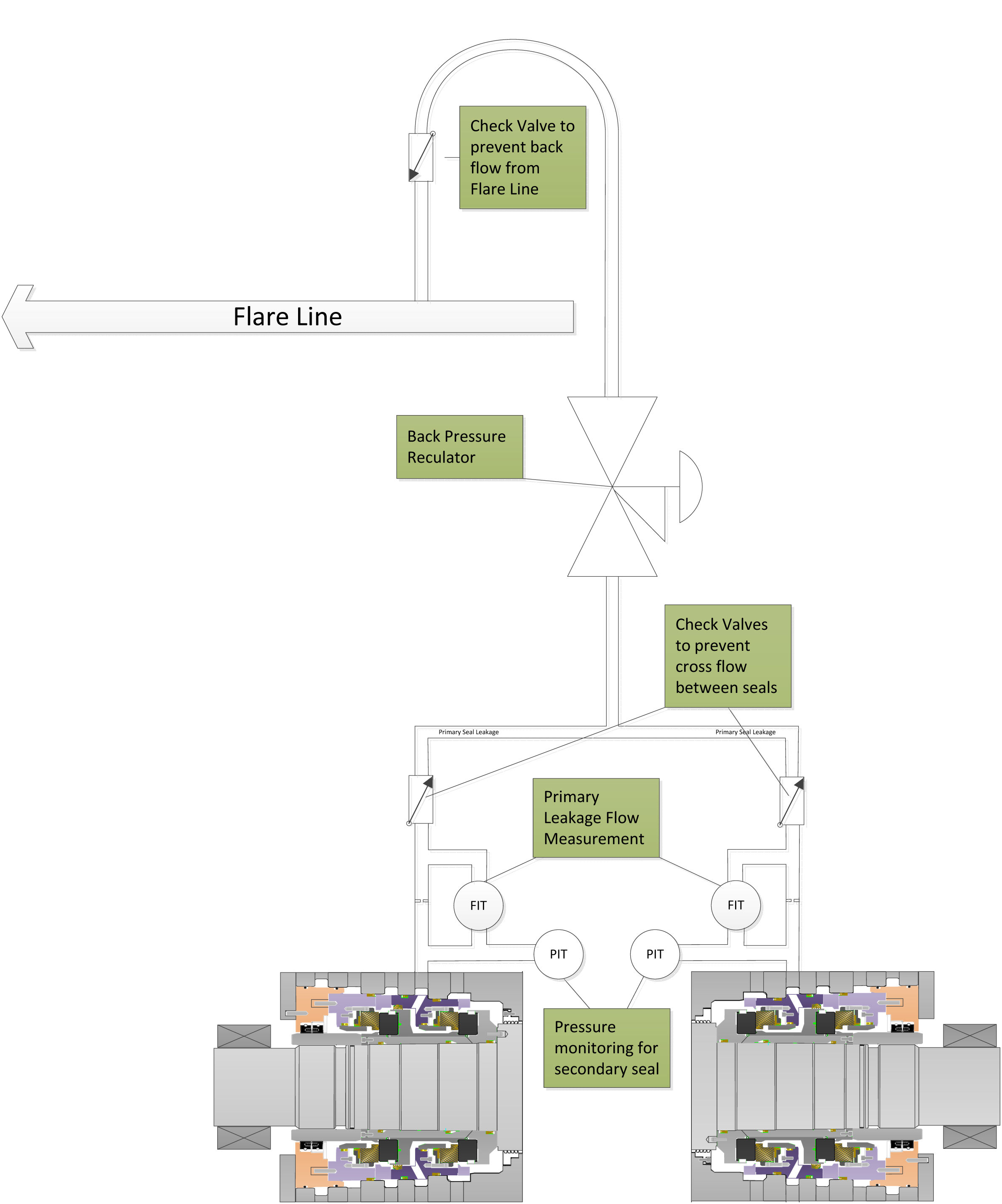

For primary and secondary vent lines, preventing and managing seal failures requires protection against seal contamination and back pressure and a sufficient line size to vent gas when a seal fails. Many seal failures have occurred due to poorly designed vent lines, incorrectly located check valves, incorrectly plumbed lines or poor atmospheric vent designs. Poorly designed atmospheric vents allow insects or rainwater to enter the line and contaminate the seal, reducing reliability and possibly causing a seal failure. When the vent line is incorrectly connected to a flare line, contamination from the flare line can enter the vent line and seal.
A screen placed over the end of an atmospheric vent line will prevent insects/debris from entering the line. While venting, the end of the vent line should be directed downward to prevent contamination building up on top of the check valve. When connecting to a flare line (see Figure 2), the check valve should be in the downward portion of the piping or tubing where it connects to the flare header. This ensures that, when the check valve opens, nothing can build up on top of the check valve and flow down into the seal.
When connecting to a flare line, correct placement of the check valves is critic
Figure 2. When connecting to a flare line, correct placement of the check valves is critical to ensure seal reliability.

Recently, an undetected secondary seal failure highlighted the industry’s need to promote the accurate monitoring of the secondary seal’s health as an important part of the dry gas seal system. To addres this additional devices must be placed in the primary vent line to create a pressure on the secondary seal, to effectively monitor its health and increase reliability.
Check valves, with specified cracking pressures and backpressure regulators, are common and reliable devices to produce backpressure in the primary vent line for applications with sealing pressures of 100 psi and greater. If a tandem seal is used for applications less than 100 psi, the system design must include precautions that reduce the risk of the primary seal becoming reverse pressured. Ideally, a double seal should be used in these applications.
Why not measure the flows in the secondary vent just like the primary vent? The challenge is that the vent line also contains nitrogen or air flowing from the separation seal. An increase in flow from the separation seal into the secondary vent can occur, producing a false indication of secondary seal failure. Furthermore, flow-measuring devices used to detect small changes in the secondary vent flow create restrictions. As the secondary vent line’s main purpose is to remove as much gas as possible during a catastrophic failure, any restrictions in this line are dangerous.
Therefore, a pressure held in the primary vent is the best approach for monitoring the secondary seal. If the pressure in the primary vent is reduced or lost, this means something has happened to the secondary seal. This requires a pressure transmitter—when the pressure decreases, an alarm sounds to indicate a possible problem with the secondary seal. Depending on the application, the operator must determine the risks of continuing to run the compressor.

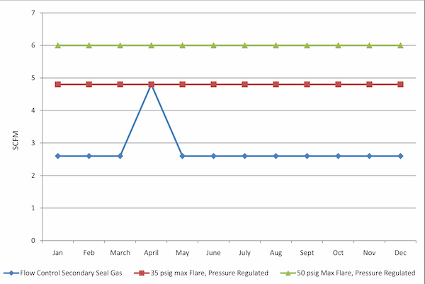

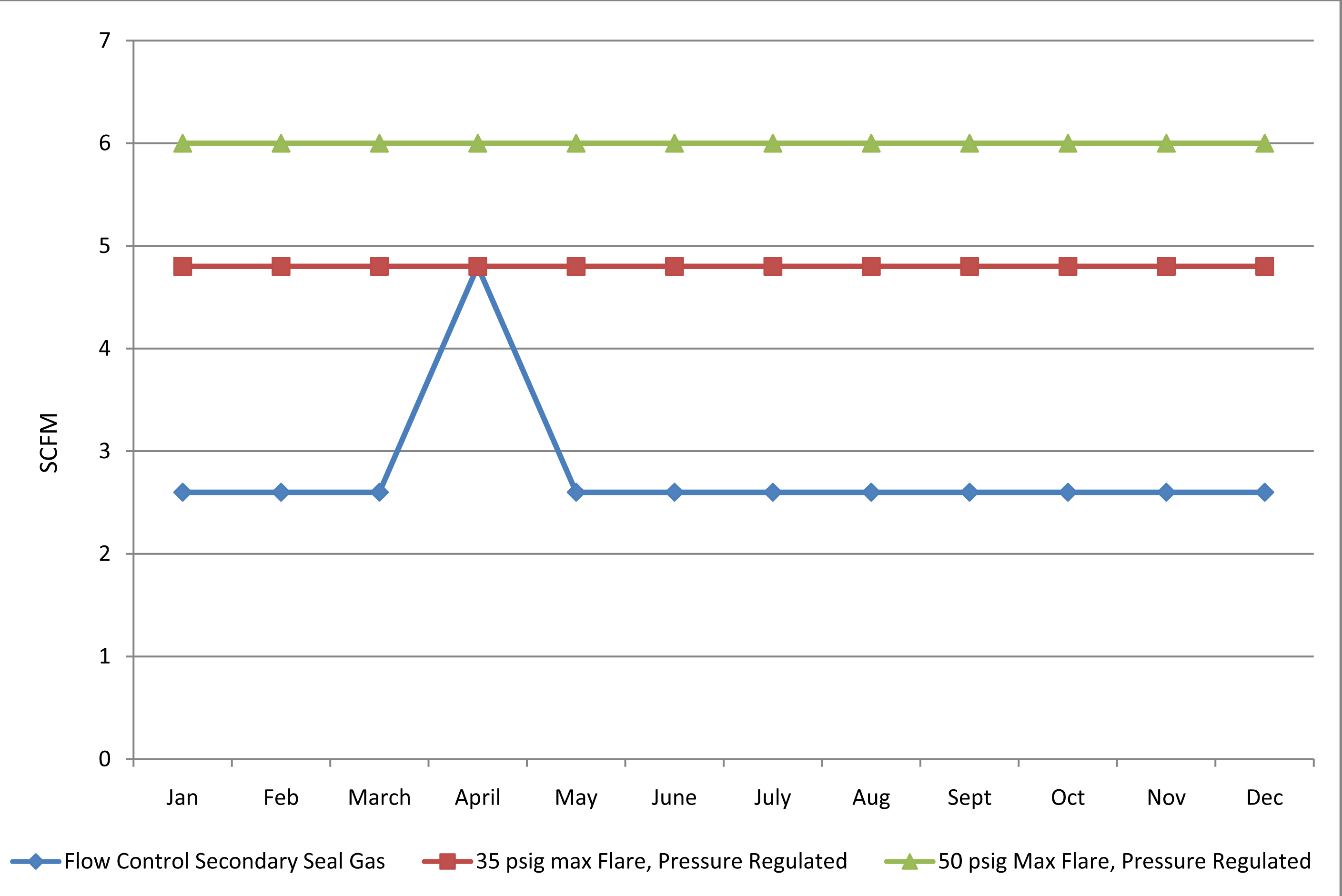

For secondary seal gas, the typical design uses a pressure regulator with a set pressure upstream of the orifice. The pressure prior to the orifice is set to manage maximum anticipated flare pressure. This results in a larger flow of gas during normal operating conditions to manage events when high flare pressure will occur, meaning that a higher than necessary amount of nitrogen is usually consumed. Using a flow control method will reduce the amount of nitrogen consumed (see Figure 3).
This graph depicts the consumption of secondary seal gas with a flow control des
Figure 3. This graph depicts the consumption of secondary seal gas with a flow control design compared to a regulator and fixed orifice configuration.
Typically, this method uses a differential pressure regulator and an orifice. The regulator senses the pressure upstream of and downstream from the orifice. This allows the regulator to be set at 10 psid and the orifice sized to provide a specified flow with the 10 psid. As the flare pressure increases, the pressure allowed through the regulator increases. The 10 psid across the orifice is maintained, increasing the flow and maintaining a minimum 5-meter-per-second flow across the intermediate labyrinth, resulting in a more efficient secondary seal gas system that consumes less nitrogen during normal operation.
Secondary seal gas systems will have a flow-monitoring device with an alarm for low or lost seal gas flow. Some applications will use a delayed shutdown, to allow time to resolve the loss and reinstate the secondary seal gas flow. The hazards created by the loss of secondary seal gas supply, as determined by the hazardous and operability study (HAZOP), dictate whether to use an alarm or delayed shutdown.
