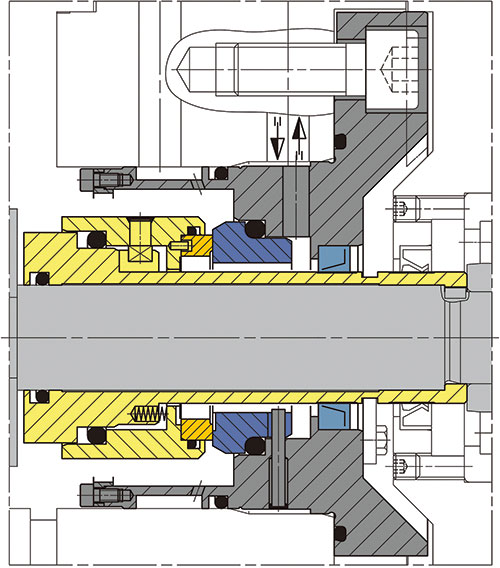

Cross-section drawing (simplified) of the diamond-faced mechanical sealCross-section drawing (simplified) of the diamond-faced mechanical seal

Many years of experience and excellent cooperation with the pump manufacturer meant that the sealing solution could be integrated into the pump without great expense. Since the sealing concept was previously proven, it took only a few steps to supply a diamond-faced seal that met the requirements. The finished product is characterized by its cartridge design, balanced principle springs that are protected from the product, and suitable secondary seals that can handle the challenges associated with pressure, temperature and medium composition.
Diamond-facing the bearing ring and stationary seat ensured that the sliding surfaces can withstand dry running for several minutes without damage and handle temperatures in the sealing gap of up to 300 C without problems. This was all possible without using complicated API Plan 32 systems. The diamond-faced mechanical seal is equipped to cope with abrupt fluctuations in the media content of the pumped mixture, which are common in multiphase applications. The spectrum ranges from pure gas to water or oil with differing solids contents.

Even though diamond-faced seals were the ideal solution to handle the difficult conditions at Panacocha, a few details needed to be addressed. All the metal components of the preassembled cartridge were made from super-duplex steel (G4) because of the high chloride content in the formation water (the water that is pumped up from the ground with the oil/gas mixture). To optimize the service life of the mechanical seal, the seal company chose an unpressurized quench for the Panacocha solution. This involved providing an unpressurized oil quench (ISO VG32) from the atmosphere side, per API Plan 62. This is distributed on the back of the sliding surface via milled hydrodynamic oil grooves or pockets, providing a slight cooling effect. These detailed and high-precision additional measures allow the diamond-faced system to perform to its best effect.
