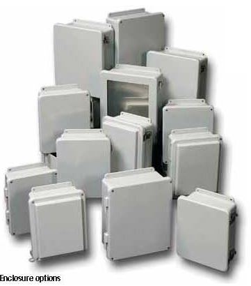

Electrical enclosure options.

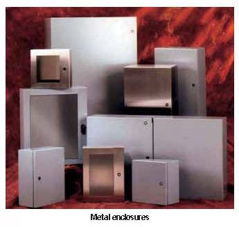

Metal electrical enclosures

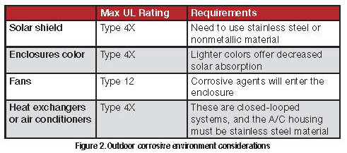

Indoor vs. Outdoor: Both Environments Have Special Considerations
An indoor environment will typically be controlled with no direct exposure to the elements—such as sun, wind, rain and snow. It can be a secured area in which building temperature can be controlled. However, many enclosures will be placed in chemical control rooms that tend to be highly corrosive areas. Some of the enclosure materials with low performance in chlorine environments include: galvanized steel and liquid painted steel. Enclosure materials that are preferred options for this type of environment include fiberglass, stainless steel, ABS and polyester (no glass fill).
In an outdoor environment enclosure materials can fade due to sun damage and extreme temperatures can affect the performance of some materials. Enclosure materials with low performance in chlorine environments include polycarbonate and ABS. Materials with optimal performance include fiberglass and stainless steel.

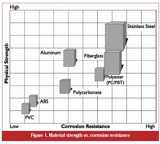

Material Strength vs. Corrosion Resistance
Strength measures the resistance of a material to failure, given by the applied stress (or load per unit area, tensile and compression). Strength is a measure of the material's ability to withstand stretching or compressing under load. On the other hand, the material's toughness is its ability to withstand sudden impacts.
Increasing strength, tensile or compression, usually decreases toughness and vice versa. Whereas steels often have high strength, they exhibit low toughness which means they dent easily and are difficult to drill or penetrate. Thermoplastics and thermosets (composites), exhibit average strength but high toughness. This means that they can withstand sudden impact and maintain their shape.
