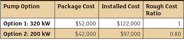

The second case study is presented for small pump installations. The following two options are considered:
- Option 1: A 320 kW pump, $52,000
- Option 2: A 200 kW pump, $42,000
Table 2. Cost analysis for two options of small pumps
Based on Table 2, only about 20 percent total installed cost reduction could be expected for a pump 38 percent smaller in size. Large pumps have economies of scale and low unit cost. In other words, unit costs of pump installations usually decrease as pump size increases.
