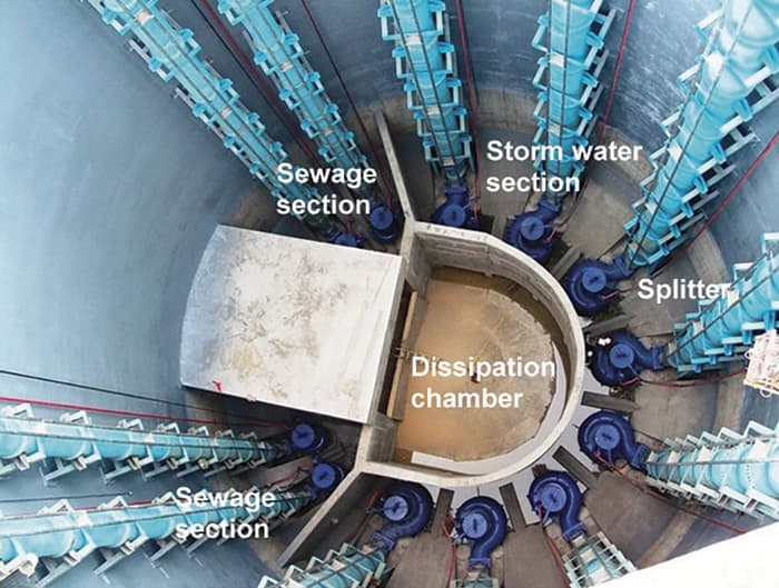

The first design aspect to consider is the pump sump and the intake's design. Even if the sewer needs a particular velocity to ensure that all solids can pass, the flow should not be too fast and too hard to create vortex. The inlet can carry a lot of air if it jumps in from a higher head. Engineers must consider these factors. For combined pumping stations that have to pump stormwater and wastewater, a good compromise between minimum velocity to transport all the content and maximum velocity to avoid vortex and entrained air has to be found. If the station only pumps raw sewage, the main risk is a slow flow can cause solids to settle. These stations often run only minutes per day and mostly with low flow. Figure 1 is an example of a stormwater station that has other requirements as a raw sewage station. Even if the stormwater station can handle different solid loads, the operating velocity will be mostly high and it will be flushed during operation. The flow will be much higher and more powerful depending on the particular storm event. Most of these stations will hold back larger material of the heavy loads by a screen before it comes to the pumping stations. The high flow will flush solids and wipes, but high flows can create vortex in the sump and cause unbalanced inflow into the pump's suction. These stations also face higher risk of air drawn into the sump and pump suction. For this reason, the inflow to the sump should not be too high or too close to the pumps. Also, having the inflow below the max water level is a good idea, but engineers must ensure that no backflow can occur. If the intake level is higher than 1 to 1.5 meters (3.3 to 5 feet), a dissipation chamber or "balcony" in front of the intake to the sump is recommended. This feature can contribute to a smaller floor footprint. 1 A dissipation balcony breaks the flow's power to prevent unnecessary vortex and helps to remove air before it enters the pumps. The fillet to the opposite wall should have a slope of approximately 10 degrees. Figure 2 shows a raw sewage pumping station sump. The footprint of the bottom level is much smaller, and the sump, wall and fillets are designed to guide the fluid with the solids and wipes to the suction area. Any area of dead zone would pose a risk of materials settling. The fillets to the wall should have a slope of 45 degrees or up to 60 degrees for heavy cases. A sump designed for raw sewage pumping stations with a larger footprint can cause problems. A growing volume of settling substances may eventually cover the pumps because they do not run often (sometimes just 15 minutes per day), and the raw sewage is thick and dries quickly. If more volume for storage is needed, it is better to use it from the vertical space.

Sump volume is calculated according to the necessary storage volume of fluid, which is related to the maximum switching frequency. However, dead zones and zones that can cause vortex or swirls should be avoided. It is recommended to have fillets with a slope of approximately 45 degrees, but 60 degrees may be better for heavy loads. The circular sump is typically preferred, but rectangular sumps are possible. Between submersible pumps, splitters are recommended. They are relatively inexpensive and minimize the influence of the flow from the pumps sitting next to each other. Also below the suction of the pump, a splitter can improve the hydraulic flow into the pump and prevent unbalanced load. Proper design and shape of the sump on the pump's backside helps to establish good flow and hydraulic conditions in the sump to improve the transport of solids. For heavy cases and large sumps, a small mixer may be used. Before the pumps start, the mixer can bring everything into suspension and help handle the load in a more homogenized condition. Compared with a valve on a discharge pipe or on a pump with the same purpose, a mixer is more flexible and powerful to flush the sump. A valve is pointed in one direction only and can clog. For stations that have floating sludge on top of the sump level, it is important not to have a constant switch level. It is recommended to pump the sump level down as much as possible. An additional small emptying pump may be helpful. A small mixer in the sump can help to create turbulences and mix the floating sludge with the other pumped medium before pumping.Inflow to the Sump
When possible, the inflow should be below the water level. Often, backflow must be prevented or other geodetic conditions prevent the inflow from being that deep. If the inflow is above the water level, the water jumps into the sump and air can be entrained. For high flows, the available energy in the flow can cause turbulences on any obstruction or the opposite wall. A baffle wall or a dissipation chamber can prevent these effects. They can remove air before it reaches the pumps, reduce the flow's energy and share the total flow between pumps in parallel operation. A dissipation chamber or "balcony" may be needed in cases with an inflow level more than 3.2 feet above the water level.1 Normally, inflow velocity into the sump cannot be defined in a tight limit, but a proven value is an average of 3.3 feet per second.Pipe Work
