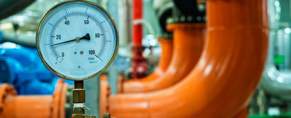

A pressure gauge performs an important role in applications, and if it stops working, then the entire process can come to an abrupt halt. If it is replaced with the wrong gauge, it can cost time, money and the safety of personnel.
Replacing a pressure gauge with the most suitable match will ensure processes can keep operating safely and efficiently. But how does a user identify their existing gauge and the replacement they should buy?
