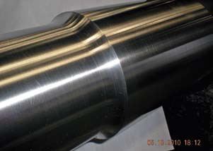

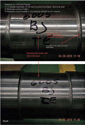

Shaft
The bearing journal surfaces were not chrome-plated. Lack of chrome plating decreases the shaft and sleeve bearing life. Chrome plating reduces surface friction, reduces wear and helps to reduce contaminants in the oil from the shaft base material.
There was also lack of smooth radii at diameter transitions. Radii help reduce stress concentrations and help prevent shaft failures.
A newly manufactured shaft with the proper radius.
Bearing journals had not been chrome-plated in previous low quality repair.

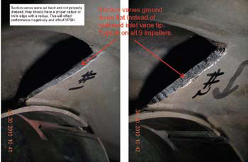

Impeller
A through crack existed at the periphery of two impellers. Defects near the periphery of an impeller can lead to catastrophic failure from centrifugal forces. Moreover, suction vane edges were ground flat, which results in a loss of performance and NPSH. As much as five to seven additional feet of NPSH required by poor practices could result in cavitation and reduced operating life.

Properly dressed impeller vane
Suction vanes had been ground down and not properly dressed.

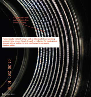

Balancing Disc
Poor machining practices left internal thread chatter. The machine tool chatter marks increase the fluid
bypass flow past the balancing disc, which reduces pressure and ultimately increases the axial thrust on the thrust bearing. The thrust bearing operating temperature will increase and result in reduced life.
Thread chatter on balance disc inner threads is evidence of poor previous machin
Thread chatter on balance disc inner threads is evidence of poor previous machining practices.
