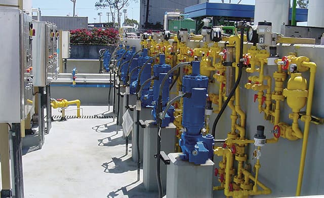

A typical metering pump application in water treatment, chemical process or agriculture can deliver large amounts of chemicals during daily operations. While the volumes may be large, the metering also must be precise, with exact amounts delivered according to strict injection schedules. The wide range of injection pressures, from high to low, must also be governed precisely. These demanding applications require the use of a unique pumping technology, one that can ensure successful, reliable adherence to the injection schedule and fluid volumes. Metering pumps have become a top choice for the injection of chemicals in water treatment, processing and agricultural applications. Many styles and modes of operation are available, so users must understand the different metering pump technologies in order to select the ideal equipment for their injection applications.

Metering Pump Installation
When designing a pumping system, users must consider any existing location or environmental concerns. Keep in mind that metering pumps are able to "push" against high pressures but will struggle to "pull" over longer distances. This means that suction lift should be limited to no more than 4 feet and that a foot valve should be used in top-mount installations. Flooded suction is always preferred in a metering pump installation to ensure the pump is easier to prime, but the length of the flooded suction should be limited to 6 or 7 feet. Other components of the installation to consider include:- Suction piping. The traditional rule of thumb is to use pipe that is one size larger than the pump's suction connection, though using pipe that is the same size as the suction connection is acceptable, if the metering pump will be operating at a slow speed when transferring low-viscosity chemicals. Generally, do not use hard piping that is smaller than 3/4-inch in diameter or that is smaller than 3/8 inch in diameter for low-flow applications that use plastic tubing.

- Calibration column. Because metering pumps often feature pulsed flow at low volumes, a draw-down calibration column is the most accurate and convenient method to measure pump performance. A tall, thin column should be used to ensure ease of reading and reporting accuracy. Calibration columns can also be helpful in determining if any wear has occurred or dirt has accumulated in the pump's check valves. If the liquid in the column "bounces," that may indicate that the valves are worn or dirty.
- Relief valve. Though the metering pump may be constructed with an internal relief valve, users should consider installing an external relief valve. It should be set at 50 psi (3.5 bar) or 10 percent above the maximum operating pressure, whichever is greater. Any chemical that flows through the relief valve is piped back to the feed tank. Using transparent tubing for the relief valve will allow the operator to observe any returned fluid and identify any impurities. When piping the relief valve's return to the suction side of the installation, the return must be upstream of the pump's isolation valve so that the flow rate will not become blocked.
