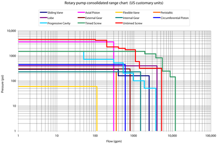

Q. Simplicity and low cost make rotary pumps a good choice for some applications. Is there a simple guide to the maximum flow rate and discharge pressure for which such pumps can be used?
A. The Hydraulic Institute has recently published a revised standard, ANSI/HI 3.1-3.5-2008, Rotary Pumps for Nomenclature, Definitions, Applications and Operation. Included in this standard are charts for discharge pressure versus flow rate for both metric and U.S. customary units. These charts include 11 different coverage lines in color for the 11 different rotary pump types. The chart in U.S. customary units is shown in Figure 1.
Figure 1
ANSI/HI 3.1-3.5-2008 includes the following changes and additions:
  • The rotary pump Consolidated Range Chart in color shows the performance map of 11 different rotary pump types in metric and U.S. customary units
  • The rotary pump Capability Table describes the operating envelope of 11 different rotary pump types in terms of solids handling, dry running, reversible operation, resistance to abrasives, allowable temperature range, shear sensitivity and self-priming ability
  • Learn the basic methods of calculating rotary pump volumetric efficiency, discharge and suction pressure, Net Positive Inlet Pressure Available (NPIPA) and Required (NPIPR), and pump power and efficiency
  • Understand the effects of entrained gas and dissolved gas in saturated solution on liquid flow rate of rotary pumps
