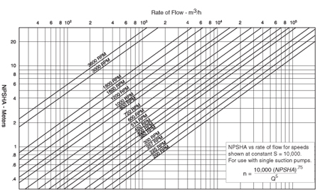

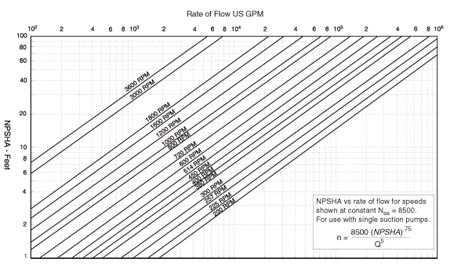

Q. Higher pump speed usually results in lower pump cost and higher efficiency. How can I determine the maximum practical speed for any given application?
A. Maximum pump speed is frequently limited by the amount of NPSH available to the pump. Experience has shown that in many situations a suction specific speed "S (NSS)" of 10,000 (8,500) with flow in cubic meters per hour (gallons per minute) is a reasonable value for most impellers. Based on this premise, the chart in Figure 1.55 shows the maximum allowable speed for single suction impellers. For double suction impellers, use one half the rate of flow for the pump to calculate the suction specific speed.
Figure 1.55. Recommended typical operating speed limits for single suction pumps (metric) [top] and recommended typical operating speed limits for single suction pumps (U.S. units) [bottom]
Suction specific speed is a characteristic of a pump that is determined by this equation:
S = nQ0.5/NPSHR0.75
Where:
S = Suction specific speed
n = Speed of pump in RPM
Q = Total pump rate of flow in cubic meters per hour (GPM) for single suction impellers and one-half total pump flow for double suction impellers
NPSHR = Net positive suction head required in meters (feet)
If we solve for n, substitute 10,000 (8,500) for (NSS) and NPSHA for NPSHR, we get:
n = 10,000 (8,500) NPSHA0.75/Q0.5
This is the recommended maximum speed for the rate of flow and NPSH available to the pump. Figure 1.55 is a graphical summary of this equation for a wide range of flow and NPSH values.
