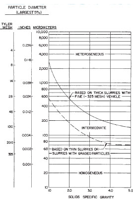

Different approaches can be used for predicting the centrifugal pump performance change from water to slurry, depending on the slurry type. When the solids-fluid mixture, as shown in Figure 12.17, is considered homogeneous and exhibits Newtonian behavior that can be characterized by an apparent viscosity, the ANSI/HI method for pump performance viscosity correction can be applied. See ANSI/HI 9.6.7 Effects of Liquid Viscosity on Rotodynamic Pump Performance.
NPSHR
The viscosity correction methods in HI 9.6.7 are empirical methods based on the best test data available from sources throughout the world. Many factors for particular pump geometry and flow conditions are not taken into account. However, the methods provide for dependable approximations when limited data on the application is available.
Pump users should consult with pump manufacturers for more accurate predictions of performance for a particular pump and particular slurry.
