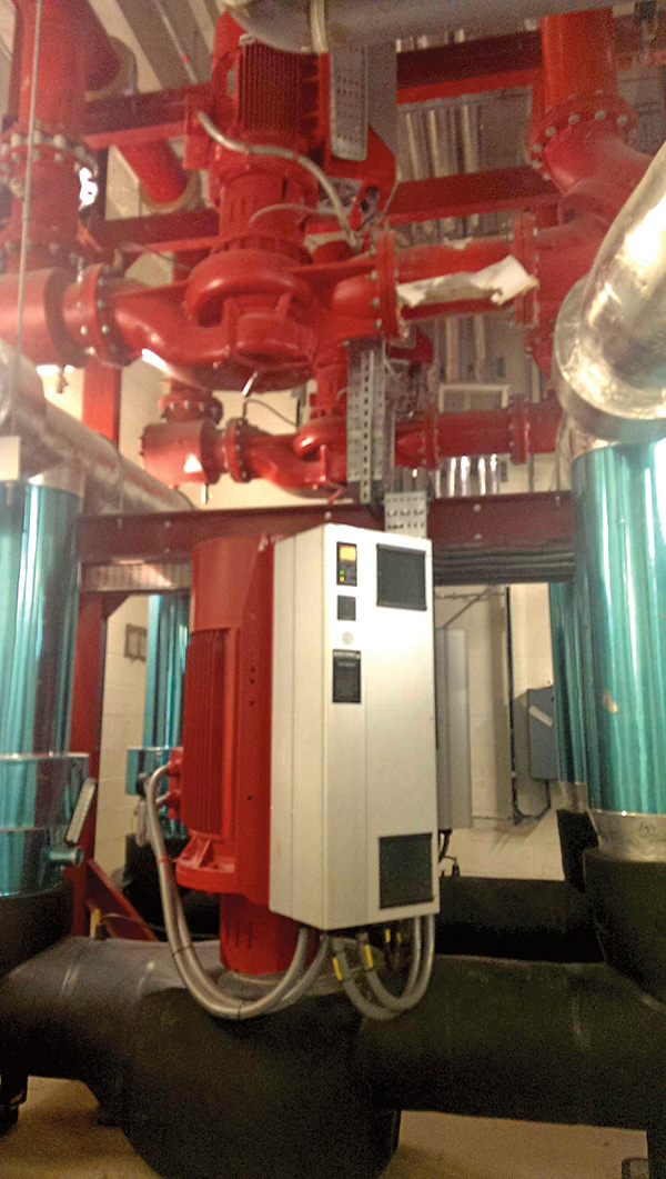

Vertically suspended pumpsImage 2. The pumps are suspended vertically, one above the other.
Suspended Vertically
One factor that affected cost efficiency was the way contemporary pumps are installed. In the days of noisy, vibrating equipment, engineers took comfort in mounting pumps squarely and horizontally on a concrete platform on the floor. At Masdar City, the pumps are suspended vertically, sometimes one above another (see Image 2). This saves space in the mechanical room, which leads to reduced capital cost. The cooling efficiencies achieved in one of the world’s hottest places are truly impressive. The integrated chilled water plant will consume 0.55 kilowatts per ton (kW/ton) (6.4 coefficient of performance—COP) or better on an annual average basis, which significantly exceeds today’s best-in-class levels of 0.75 kW/ton (4.7 COP) for water-cooled systems. Even in the more than 51 C peak heat of summer, the readings are between 0.73 to 0.85 kW/ton for the full plant. Thanks in part to advances in HVAC technology, inside the renewables mecca of the desert, it remains cool.
