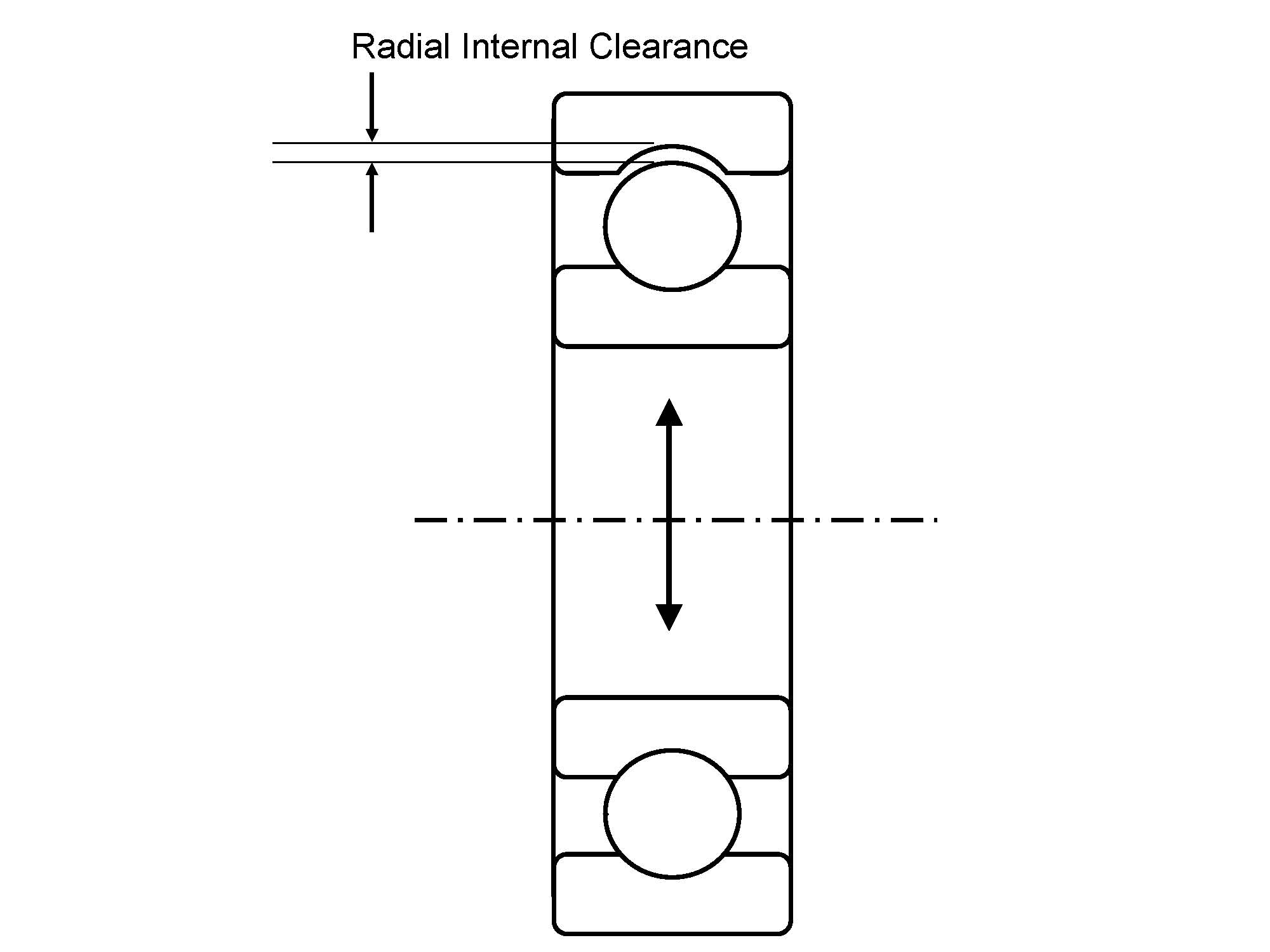

To understand why proper mounting techniques help to improve bearing life, it is first necessary to understand bearing radial internal clearance and how it changes from the unmounted condition to the mounted condition.
Figure 1

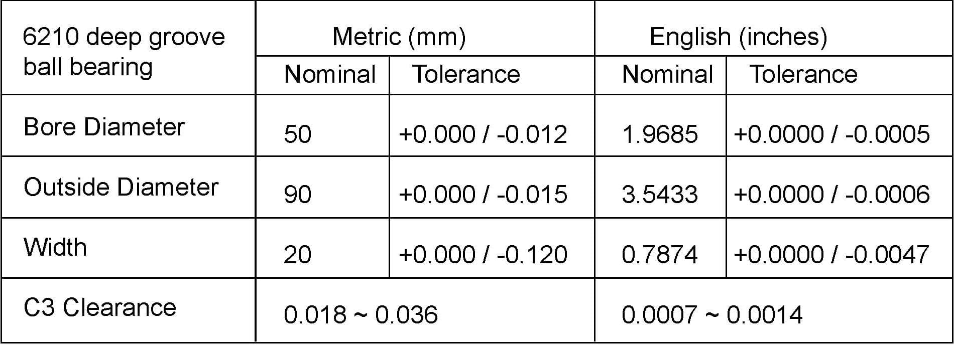

Simply stated, radial internal clearance is the distance that the inner ring of a bearing can be moved while the outer ring is held stationary. In a bearing, this clearance is quite small when compared to overall dimensions of the bearing. Table 1 shows both the external dimensions (and tolerances) and the C3 radial internal clearance for a 6210 deep groove ball bearing.
Table 1

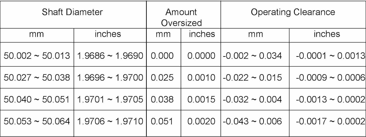

When this bearing is mounted into a device such as an electric motor, there should be an interference fit between the bearing’s inner ring and the shaft. As a result of this interference, the internal clearance of the bearing is decreased. For a 6210 ball bearing, the radial clearance will decrease from 0.018-mm ~ 0.036-mm to minus 0.002-mm ~ 0.034-mm (minus 0.0001-in ~ 0.0013-in) when it is mounted onto a shaft with the recommended k5 fit, which is 50.002-mm ~ 50.013-mm (1.9686-in ~ 1.9690-in) in diameter.

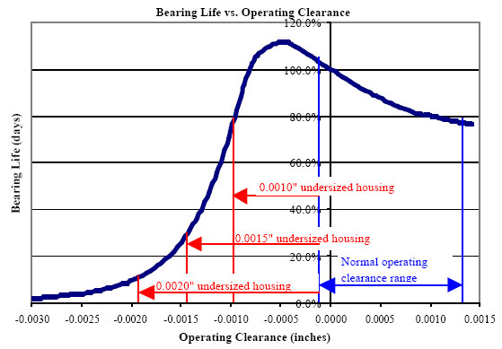

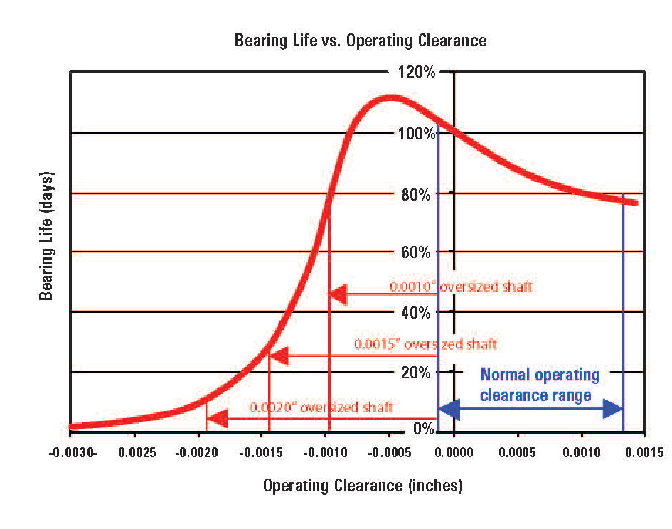

Now, how does any of this relate to bearing life? Figure 2 shows a graph of how radial internal clearance and bearing life are intimately tied together. As you can see, bearing life will exceed the predicted value (100 percent life) when the clearance of the bearing in operation is slightly negative, meaning that the bearing is radially preloaded.
Figure 2.
Unfortunately, trying to design your fitting practices around achieving this added bearing life can be hazardous. Table 2 and Figure 3 show what might appear to be a minor machining mistake can have disastrous effects on the life of a 6210 ball bearing. Table 2 summarizes how slight changes in shaft diameter will drastically affect operating clearance.
Table 2
Figure 3
To relate this back to bearing life, for the correctly-sized shaft, the bearing life when the operating clearance is at a minimum is approximately 102 percent of the calculated life. For the 0.025-mm oversized shaft this becomes 93.6 percent, for the 0.038-mm oversized shaft this decreases to 43 percent and for the 0.051-mm oversized shaft the life plummets to 17 percent of the predicted life.
To make matters worse, these numbers only look at the internal loading of the bearing. Other significant factors, such as excessive heat generation and lubricant breakdown, have not been considered. When these are factored in, the bearing could fail in a matter of days or even hours.

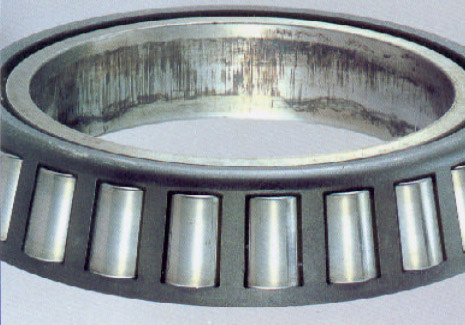

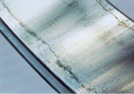

Luckily, if these bearings are caught during regular maintenance before they catastrophically fail, then a good deal of evidence about the bearings can be learned by examining them. For instance, Figure 4 shows the bore of a bearing that exhibits a phenomenon called scuffing.
Figure 4

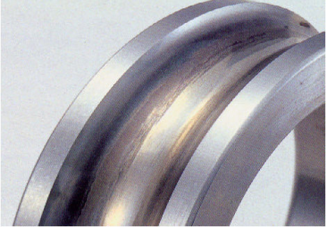

When found on the bore, scuffing is a result of an excessive interference between the bearing and the shaft and can be viewed as deep axial scratches in the metal. As a result, care should be taken when this machine is rebuilt to insure that the shaft is machined to the proper dimensions.

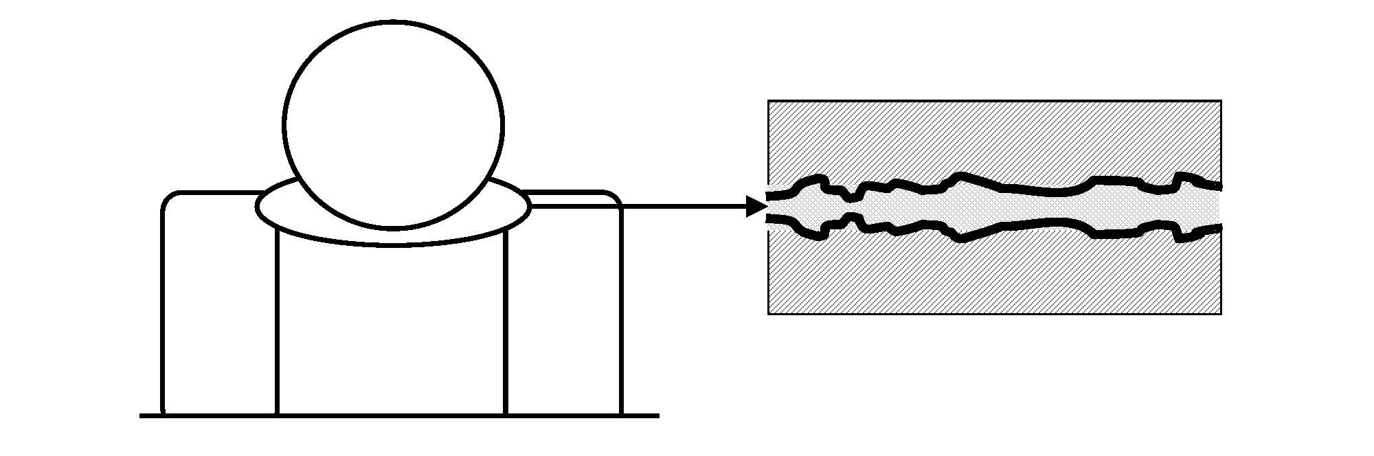

For the ball bearing shown in Figure 5, a phenomenon called smearing can be clearly seen.
Figure 5
Smearing occurs if the oil film disappears as the rolling elements stop rotating and start to slide on the raceway surface, which results initially in microwelding internal to the bearing. Typically, smearing occurs in high-speed applications, however, a similar phenomenon occurs in bearings that have been highly radially preloaded. In addition to smearing, lubricant staining can be seen on both sides of the ball path as a result of the high temperatures experienced during the smearing process.

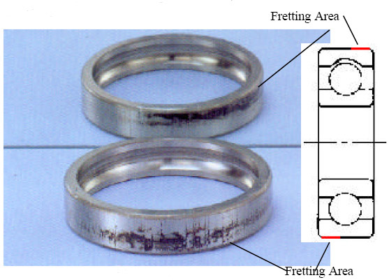

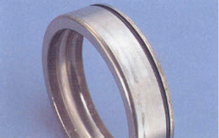

Bearings mounted on undersized shafts would indicate so by showing fretting on their bores (see Figure 6).
Figure 6
Fretting manifests itself when minute speed changes cause the shaft to slip/vibrate inside the bearing bore, and is a precursor to the galling and friction welding described previously.

To combat this, a properly designed housing is made to be slightly larger than the bearing. For our 6210 ball bearing, the housing should be machined to 90.000-mm ~ 90.022-mm (3.5433-in ~ 3.5442-in). This allows for a phenomenon called creep to occur. Slight creep of an outer ring is a benefit because it allows the outer ring of the bearing to rotate extremely slowly in the housing, due to the traction of the rolling elements on the outer raceway. Consequently, the loaded portion of the outer ring changes over time.
Figure 8 shows a more extreme case of creep than is desired. The slight creep that is desired more closely resembles fretting but with a circumferential pattern.

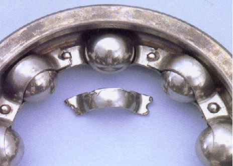

With this same oversized housing, the possibility exists to mount the bearing in a misaligned state, meaning that the outer ring is tipped with respect to the housing bore. In this instance, during assembly, the bearing will not slide easily into the housing, giving the impression to the assembler that the housing was not oversized. As a result, during operation, the rolling element complement would be forced from one side of the bearing to the other.
For cases of slight misalignment, this would cause the bearing retainer to twist as it follows rolling elements and would eventually result in a fatigue failure of the cage (see Figure 9). For bearings with moderate to severe misalignment, the rolling elements will decelerate and accelerate as the balls enter and exit the areas of high loading. This speed change of the balls will cause a stretching/compressing of the cage which again would result is a cage failure, as shown in Figure 9.
Figure 9
If routine maintenance that includes vibration analysis is performed, this type of failing can sometimes be caught prior to failure. The vibration analyzer might detect the misalignment and indicate that the rotating mass is unbalanced there. If this was the case and the unit disassembled, Figure 10 shows symmetrical fretting on the OD of the bearing, which is evidence of a misalignment problem (note there is only one bearing in this figure with a mirror in the background).

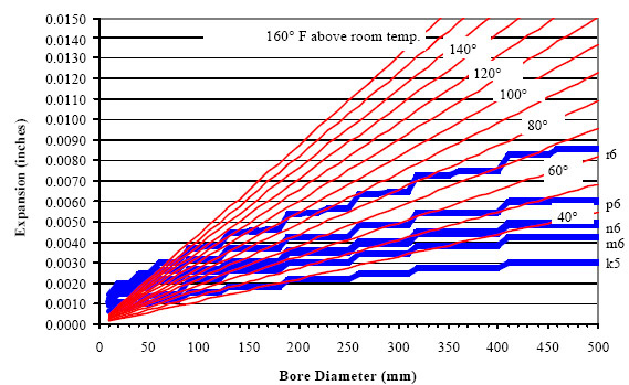

Typically, larger bearings are heated either on a hot plate, in an oven, in an oil bath, or by an induction heater (a torch is not an acceptable method for heating bearings). The objective is to increase the diameter of the bearing bore by thermal expansion so that it will easily slip onto the shaft. The recommended method for non-mass production mountings is the induction heater. Modern induction heaters have temperature controllers in them so that overheating does not occur. Additionally, they are equipped with automatic demagnetizers to degauss the heated bearings.
In all methods of heating a bearing, special care must be taken to insure that the temperature of the bearings does not exceed 120-deg C (250-deg F). Above this temperature, the hardness of the steel may be reduced and the dimensional stability of the bearings may be lost. When older induction heaters are used, the bearings must be degaussed so that they do not attract metallic contamination.
Additionally, due to the expansion rate of bearing steel, it is not necessary to ever exceed this temperature. For our 6210 ball bearing mounted on the k5 shaft (50.002-mm ~ 50.013-mm), it is only necessary to heat the bearing by approximately 40-deg C (75-deg F) above room temperature until the bore expands to 50.014-mm.
Fortunately, steel cools reasonably quickly, so we would be wise to heat the bearing above this temperature to allow us to get from our heating device to the shaft. Therefore, warming the bearing to 55-deg C to 60-deg C (100-deg F to 110-deg F) above room temperature would be sufficient. Figure 11 below can be used as a reference for determining how hot to get the bearing.
Figure 11
Once a hot bearing has been mounted onto the shaft, it will begin to cool. At some point, a single section of the bore will cool to the point that it comes into contact with the shaft. This will be the point where the bearing seats itself. Based on this, it is possible that the cooling process will pull the bearing off of the shaft shoulder. Therefore, the bearing should be reseated onto the shoulder once it has cooled to room temperature (the light impact method should be used).

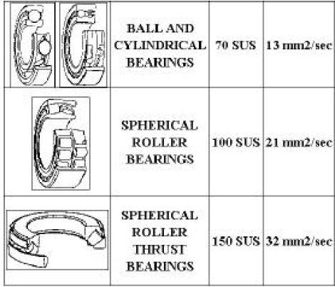

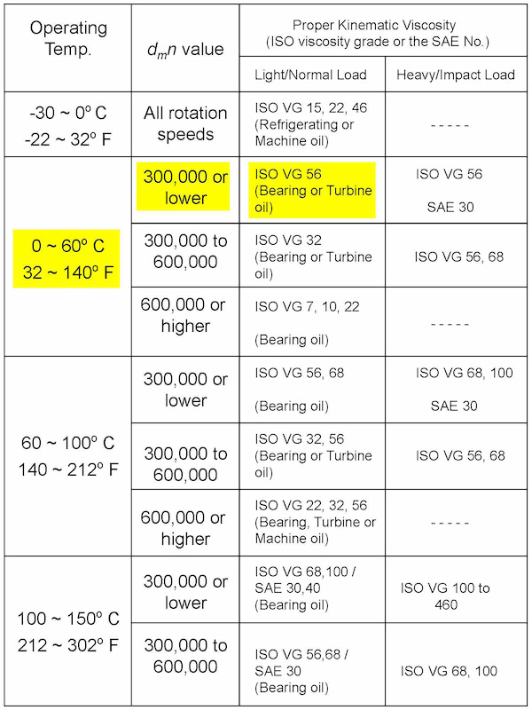

One of the most critical characteristics of a bearing lubricant is its viscosity. Simply stated, the viscosity is the ability of a liquid to flow at a given temperature. A fluid with a low viscosity is a fluid that flows quite readily, such as water. A high viscosity fluid would be one that is more resistant to flow, such as molasses. Additionally, the viscosity of a fluid decreases as the temperature increases.
The reason that the viscosity of a fluid is important to a bearing is that in normal operation, the rolling elements should not actually touch the raceways, but be supported by a thin film of oil (Figure 13).
Figure 13
And it is essentially the lubricant’s viscosity that allows this to occur. Metal-to-metal contact in bearings occurs when the lubricating fluid is too thin, causing rapid wear and increased heat generation.
To insure that rolling surfaces are properly separated, a lubricant with an appropriate viscosity must be chosen. Table 3 can be used as a guideline for selecting an oil with the proper viscosity for any given application, assuming that four pieces of information are known:
  1. Bearing operating temperature
  2. Bearing pitch diameter (dm = (bore dia. + OD)/2)
  3. Operating speed (n)
  4. Bearing loading level (light/normal or heavy/impact)
Table 3
Let us imagine that our 6210 ball bearing from the previous examples were to be operating at 3600-rpm, at a temperature of 90-deg C (194-deg F), under normal loading conditions (normal load can be defined as having a ratio of the dynamic capacity of the bearing to the applied load (Cr/Pr) between 0.06 and 0.012  0.06 <Cr/Pr ≤0.12). First we would determine that the pitch diameter equals 70-mm ((50-mm + 90-mm)/2), then multiply this by our operating speed to get the dmn value of 252,000. From this we would refer to Table 3 and see that we should use a ISO VG56 or VG68 (SAE W30) bearing oil or turbine oil (yellow highlighted section).

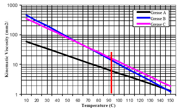

For applications designed for grease lubrication and not oil lubrication, the same care must be taken to insure that the base oil of the grease will properly separate the rolling surfaces. Unfortunately, greases do not use the same VG or SAE ratings as oils do, so we have to employ a slightly different technique to determine which grease is appropriate.
First, the minimum viscosity required for the type of bearing being used must be determined based on Table 4.
Table 4
Next, a base oil viscosity curve for the grease must be obtained. Figure 14 shows viscosity curves for three different greases.
Figure 14
Then we simply draw a vertical line from the operating temperature until it intersects the viscosity curve(s) to determine the viscosity at a given temperature. For our 6210 ball bearing, at 90-deg C we find that grease A has a viscosity of 6.7-cSt (centistokes), grease B 15.7-cSt, and grease C 17.7-cSt. From this we know that grease A would not be an appropriate choice for our bearing, whereas greases B and C would meet our viscosity needs.
Now, how would we decide whether grease B or C is the best grease for our application? To do this, we have to look at other aspects of the application, such as: Is it in a dry or humid/wet environment? Can it be re-lubricated easily, or is the bearing going to be sealed for life? What is the lowest temperature that the machine could see at start up?
The answers to these questions will help us to select the grease with the characteristics to meet the needs of the application. As a general rule, greases made with Lithium soap thickeners have good water resistance but tend to have a somewhat shorter life than some other thickeners. Calcium-based greases also have good water resistance, but commonly do not operate well at high temperatures. Urea or polyurea greases typically last longer than Lithium greases, but may have higher noise characteristics.

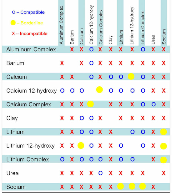

If the application is going to be regularly maintained and regreased, then it is critical to know what type of grease was originally in the bearing and what type of grease is going to be used to regrease it. The reason for this is because not all greases are compatible. The chart shown in Figure 15 can be used as a general rule of thumb for compatibility, but the best rule is to regrease with the original grease because even some greases with the same thickeners are not compatible because of the additive packages or base oils. And some greases may actually be compatible where the chart indicates that they are not.
Figure 15
If there is any question of compatibility, the best solution is to completely remove the old grease during the regreasing process. This can be accomplished by the conducting the following procedure:

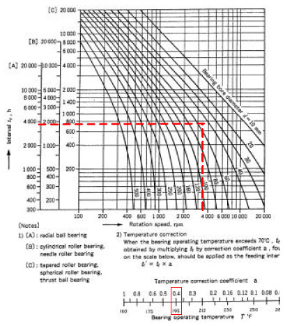

How often a bearing should be lubricated is as important as using the proper relubrication techniques. A common mistake is to assume that if a little grease is good, then more grease is better. In reality, an under-greased bearing is better than an over-greased one. Bearings only require about 30 percent of their free space to be filled with grease. Any excess amount will be expelled from the bearing. However, if the bearing and its cavity already contain too much grease, then there will be nowhere for the expelled grease to go and the bearing will heat up and progress towards failure. Additional grease will only exacerbate this and accelerate the failure.
Every bearing operating in a facility should have its own regreasing schedule so that it is not either over- or under-greased. To determine the timing for the regreasing, the chart shown in Figure 16 can be used as a guideline. To use this chart, draw a line up from the operating speed until it crosses the bore diameter of the bearing. Then draw a line across to determine the relubrication interval.
Figure 16
To continue with our 6210 ball bearing operating at 3600-rpm, you would draw the dashed red lines shown on the chart. Reading off the hours from [A], it can be seen that it should be regreased about every 3900 hours. However, we also know that this bearing is operating at 90-deg C (194-deg F). Therefore, we need to correct this value for the increased operating temperature.
By examining the line graph at the bottom of Figure 16, we find that we should use a ‘temperature correction factor’ of 0.4. When we take this into consideration, the actual relubrication frequency for the 6210 is 1560 hours (3900 hrs * 0.4 = 1560 hrs), or about once every two months. Please note that cylindrical and needle bearings need to be relubricated about twice as often as ball bearings. Tapered and spherical roller and thrust ball bearings need new grease about 5X as often.
In Step 5 of our relubrication guidelines, it says to ‘add new grease.’ How much is as important as how often. Unfortunately, two or three squirts from a grease gun often does not introduce the proper amount of grease. This is true because not all grease guns deliver the same amount of grease per squirt. One gun could give you as little as ½-gram of grease, whereas the next could give more than 3-grams.
To this end, a complete maintenance program should take the steps to measure the amount of grease that their guns dispense about once a year. That way, the maintenance card on each piece of equipment can specify the number of squirts instead of the number of grams that should be added to the bearings.
To determine the amount of grease to add to each bearing, use the following formula:
G =  0.005  x  D  x B
Where:
G = amount of grease in grams
D = OD of bearing in mm
B = width of bearing in mm
For our 6210 this would be:
G =  0.005  x  90  x  20  =  9 grams

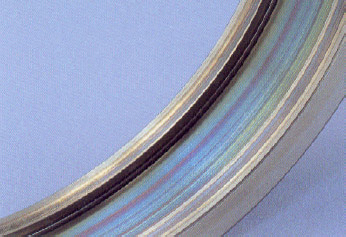

Finally, assuming that a piece of equipment is stopped before the bearings catastrophically fail, an analysis of those bearings can readily identify lubrication issues. The bearing shown in Figure 17 was caught very close to the point of seizure.
Figure 17
The coloration (bluing) of the raceway in this cylindrical roller bearing indicates that this bearing reached 400-deg C to 500-deg C (750-deg F to 930-deg F). This type of failure is indicative of an over-greasing problem, where grease was continuously added to the bearing in an attempt to cool it.

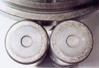

During the discussion on mounting, scuffing was identified as an indicator of excessive interference if found on the bore of the bearing. Scuffing can also be found on the thrust ends of cylindrical, tapered or spherical thrust roller bearing rolling elements (see Figure 18).
Figure 18
This internal scuffing is an indication that the sliding surfaces of the roller ends were not properly lubricated. These sliding surfaces demand that these type of bearings use a more viscous lubricating oil, as was shown earlier in Figure 4.
