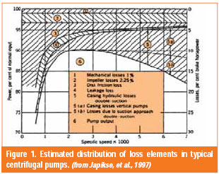

Figure 1 is a well-known plot from Stepanoff (1948, 1957), showing roughly the breakout of losses in various pumps. To achieve superior designs, we must mitigate these losses. Similar diagrams exist for radial compressors and turbines because they all have the same core issues involved: friction dominates at low specific speeds, and kinetic energy effects dominate at high specific speeds. (For instance, items 5a and 5b in Figure 1 are actually kinetic energy effects also found in other machinery classes.)
Estimated distrubution of loss elements in typical centrifugal pumps
Figure 1 shows that at low specific speeds, the process is dominated by friction (particularly disk friction) and, in some cases, leakage losses. On a direct assault, we will make little headway against such a tough challenge. At high specific speeds, the game changes: one must be careful to deal with kinetic energy effects (disk friction may be a tiny contributor), so we must treat all viscous processes with care and achieve excellent diffusion and overall control of the flow field. This is a different design challenge, and one for which superb tools exist.
Do not forget the middle ground in Figure 1 because the highest efficiencies are found there. Efficiencies can be several points higher than at nearby higher and lower specific speeds. A change in speed is needed to reach this middle ground, at least for many instances where both head and flow may be frozen.

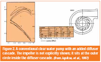

Speed can be adapted quite easily today and carries a small price for gaining efficiency, a price often compensated by improved part load operations and savings. Our traditional reliance on simple synchronous motors needs to be updated, and, in some cases, greater care will have to be taken to avoid cavitation (see below). The good news is that higher rotational speeds lead to smaller diameter machines, which afford greater design opportunity. One of these opportunities is the potential to include a proper diffuser to achieve a more efficient stage, and while these are now used worldwide for high performance engineered pumps, they are not common for mass-produced pumps.
Figure 2 gives an example of a pump stage reported in the past in Holland.
A conventional clear water pump with an added diffuser cascade.

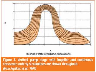

Now, with better design speed, some reduction in diameter and a diffuser included, there is the possibility of a performance gain-one that is worthy of real design optimization. Other possibilities exist as well, including the usage of high performance crossovers for multistage pumps, such as shown in Figure 3.
Vertical pump stage with impeller and continuous crossover, orderly streamlines
These crossovers have been shown to have excellent diffusion and low losses, a fact that can be carried over to many other applications.

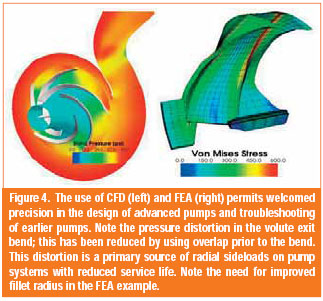

CFD is based on a full 3-D solution of the Navier-Stokes equations, which are the full viscous flow equations governing the processes of interest. FEA is the full 3-D solution for the solid body forces and the body response to the operation of the hardware. Figure 4 illustrates some of the computational possibilities.
The use of CDF (left) and FEA (right) permits welcomed percision in the design
It is only recently that we could even dream of possible solutions for these equations, and only the last few years have given us fast, powerful computers for individual usage with these systems. We must, therefore, be careful of shortcomings that might accompany these powerful but new tools.
