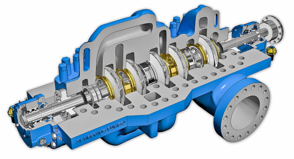

Desalinated water has been proven effective for most mining processes, especially in copper mining—such as copper flotation and SX/EW. Some mining companies use raw seawater in their processes. This has become a technological challenge for engineering and pump companies. They must select advanced materials that can withstand the saltwater corrosion, such as duplex or super duplex stainless steels. They must also consider special design criteria for high pressures and heavy-duty operations. As a result, most seawater desalination plants use basically the same equipment and technology for their processes, with vertical turbine pumps on their intake station, followed by a number of booster stations equipped with high-pressure axial split case pumps (see Figure 1).
Axial split case pumps are ideal for high-pressure, corrosive applications
Figure 1. Axial split case pumps are ideal for high-pressure, corrosive applications
The main challenge for this application is not the treatment cost, as membrane desalination technologies—for reverse osmosis (RO) plants—have become increasingly attractive. The large part of the costs is associated with transporting the water from sea level up to the mining operations. Today, the cost of transporting treated seawater to high-altitude mining operations can be up to 10 times the cost of producing the desalinated water on the coast.
