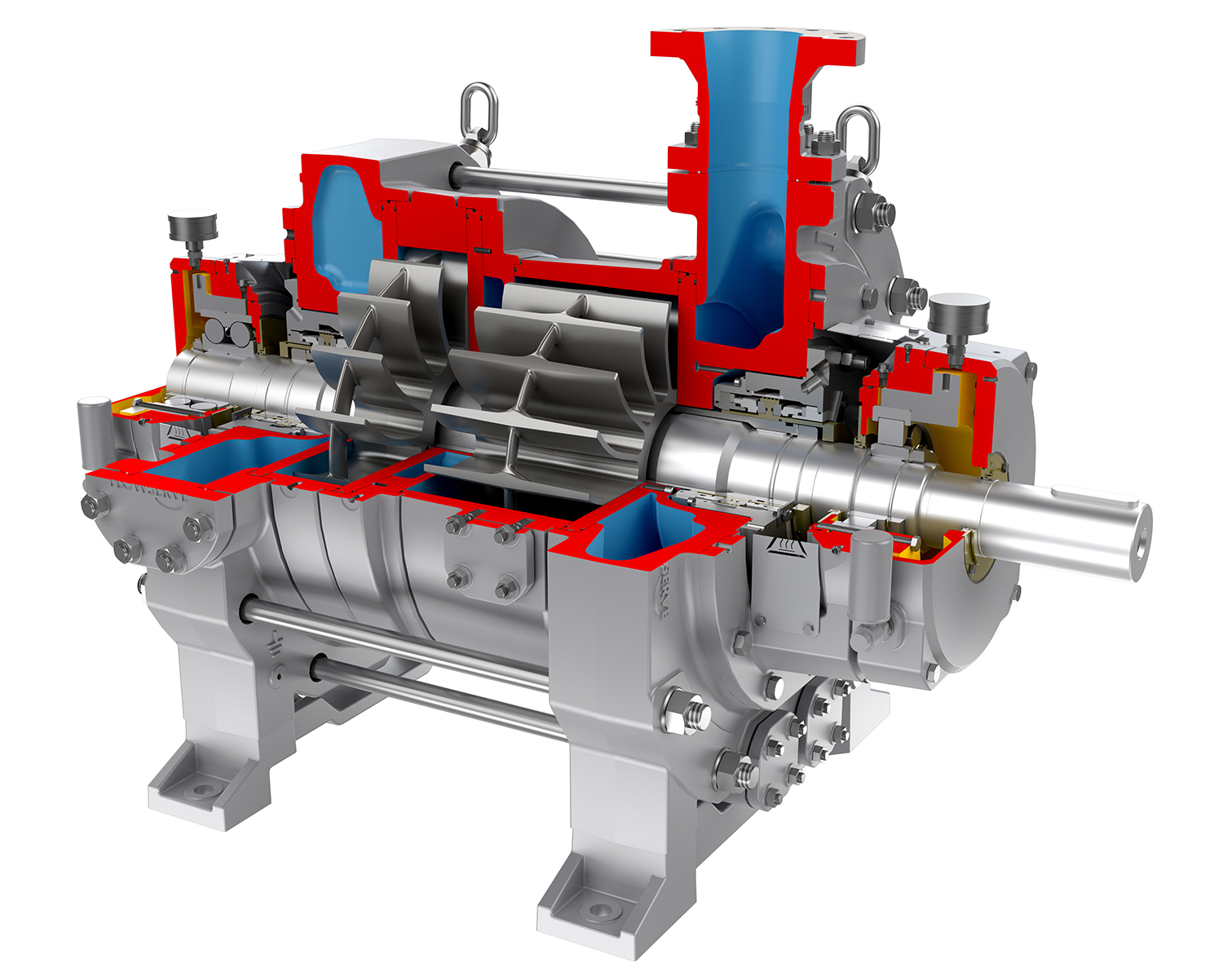

![Liquid Ring Compressor](/sites/default/files/2020-10/Aragon-V3-RSectioned_R3d.jpg)
Liquid ring vacuum compressors are used across process industries, especially for the recovery of gases and vapors. They are used in applications where severe conditions exist and safety is a critical requirement. Demand for this equipment is expected to continue to grow at nearly 5 percent a year through 2029 because liquid ring compressors offer reliable solutions in refinery applications that recover flare gas. Liquid ring compressors also are ideal for specialized applications such as chlorine or hydrogen compression and in the production of vinyl chloride monomers, biodiesel or ethanol, and other transesterification processes.

How Liquid Ring Compressors Work
Liquid ring compressors occupy a special position among the types of compressors because there is no contact between the individual parts to create friction:
- An impeller with curved blades rotates inside a cylindrical casing filled with a service liquid (typically water).
- The rotation creates centrifugal force that forms a moving ring of fluid against the interior wall of the casing.
- This results in a volumetric expansion in the outflowing section of the liquid ring, which causes the gaseous process medium to be drawn in via the inlet port in the guide plate.
- In the inflowing section of the liquid ring, the volume is reduced, compressing the medium.
- After compression, the medium is discharged via the outlet port in the guide plate with the service liquid.
The medium being pumped comes into contact with the service liquid, thus allowing these media to affect each other.

Compressor Design
The rotors of some liquid ring compressors available today have been designed with an increased hub diameter for maximum loads in terms of bending load and intrinsic frequency. Any axial loads are absorbed by oil-lubricated bearings. The bearing clearance is kept as short as possible to prevent shafts bending under any operating conditions. Other features to consider when evaluating which compressor best matches a user’s process requirements include:
Isothermal efficiency
The vanes of each impeller inside a liquid ring compressor are curved for optimum energy transfer. As the compression power is derived from the energy generated by the rotary movement of the liquid ring, the amount of energy it contains should be at least equivalent to the isothermal compression rating. The design supports stable liquid ring conditions over the full available pressure ratio between inlet and outlet pressures. Internal guides for the service liquid minimize internal losses on the axial sealing surfaces between the impellers and guide discs. Overflow losses are then reduced.
As a result, isothermal efficiency is improved by as much as 23 percent³ while also reducing power consumption.
Reduced radial forces
A second stage is used on some compressors to manage high differential pressure. The center body of this stage is designed so that the liquid ring flows into and out of the impeller blade cells twice during each revolution of the impeller. This ensures that radial forces are avoided and shaft deflection is minimized in order to reduce vibrations, which can negatively affect efficiency and service life.
