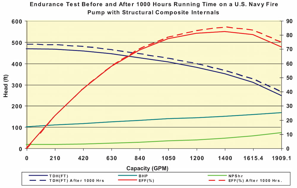

One of the many benefits of enclosed structural composite impellers and rings is that the impeller performance will not deteriorate over time like a metallic enclosed impeller or an Open-faced impeller. With an enclosed composite impeller, the clearances are permanently set between the impeller wear ring and the pump casing ring or the pump housing. Since the structural composite will not gall, seize or corrode like metallic rings, the clearances can be controlled, as can the pump performance and efficiency. Figure 2 shows that an enclosed structural composite impeller will increase the head-capacity (H-Q) curve after 1,000 hours of operation as a result of the rings and impeller operating together.
Endurance Test Before and After 1000 Hours Running Time
