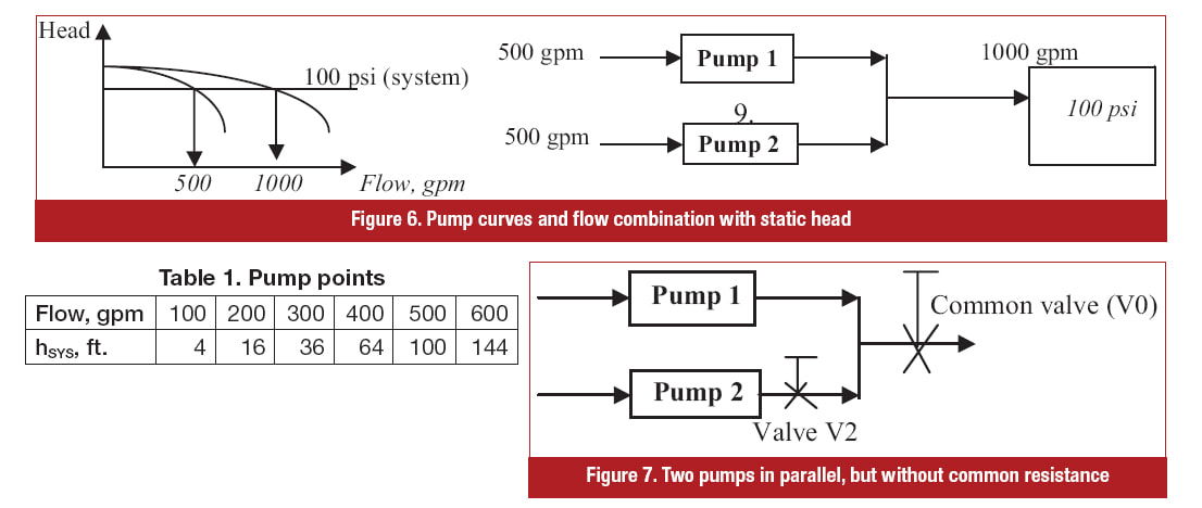

When only one pump was operating, the flow was 500 gallons per minute (gpm). However when the second pump came online, they did not produce twice the flow, (1,000 gpm). Instead, only 600 gpm flows through the system. The reason is the shape of the system's resistance curve. However, if the pumps were pumping against mainly a static head (such as pressurized tank), then the flows would be additive. This is because the static head curve is not a parabola, but a straight line, independent of flow and parallel to the flow axis (Figure 6).

In the previous example, the change of the valve setting (changing valve, K, coefficient) affects both pumps the same. However, what if the system is set up as in Figure 7?
For simplicity, assume that the pumps and valves are identical and that each valve is throttled the same percentage (i.e. having the same coefficient "k"). Several points from the curves have been entered into Table 1.
We know the following:
  • There are no other losses except for the valves. In other words, all other losses have been combined into the equivalent valves (V0 and V2).
  • Valve V0 sees the combined flows from Pumps 1 and 2.
  • The head generated by Pump 1 is equal to the pressure drop (head loss) across V0. Because of the pressure continuity, the nodal point at the exit of Pump 1 is the same as the entry point into V0.
  • V2 sees flow from Pump 2 only.
  • The system must be in balance to satisfy individual pump H-Q curves and individual valve h-Q curves.
The solution is iterative:
a) Guess at the flow from Pump 1, Q1 = 250 gpm.
b) Per H-Q curve of Pump 1, head H1 = 118 feet.
c) Head loss across valve V0 is equal to the head generated by Pump 1, i.e. valve h1 = H1 = 118 feet.
d) From the V0 curve, Q0 = 543 (We actually "cheated" a bit here—got the equation for the parabola, h0 = Q02/2500—and then just plugged in the numbers).
e) Total pumps flow is equal to what is flowing through V0, i.e. QTOTAL = Q0 = 543.
f) Flow through Pump 2 is the difference: Q2 = Q0 – Q1 = 543-250 = 293 gpm.
g) From the Pump 2 curve (Using identical pumps in this case), H2 = 116 ft. (Approximately, as it is more difficult to derive the polynomial equation for the pumps; for the valve it is easy, a parabola).
h) A pressure drop across V2 is the difference between the pressures at its exit and inlet. The exit pressure is equal to what Pump 1 generated, and the inlet is what Pump 2 generated, i.e. h2 = 116 – 118 = -2 ft.
The solution (-2) is impossible. The first guessed flow from Pump 1 was wrong. Let's try again:
a) New guess, Q1 = 300 gpm
b) H1 = 115 ft.
c) h0 = H1 = 115 ft.
d) Q0 = 536 gpm
e) QTOTAL = Q0 = 536 gpm
f) Q2 = Q0 – Q1 = 536 – 300 = 236 gpm
g) H2 = 119 ft. from pump curve
h) h2 = H2 – H1 = 119 – 115 = 4 ft.
i) From valve curve (or interpolating from the Table), Qvalve2 = 100 gpm
j) Q2 = Qvalve2 = 100 gpm (from the flow continuity – what flows to Valve 2 has to come out of Pump 2).
The solution arrived at above is not equal to Pump 2's flow as derived at Step f. So, we need to guess again. (But we are getting closer).
a) Next guess, Q1 = 400 gpm
b) H1 = 113 ft.
c) h0 = H1 = 113 ft.
d) Q0 = 532 gpm
e) QTOTAL = Q0 = 532 gpm
f) Q2 = Q0 – Q1 = 532-400 = 132 gpm
g) H2 = 119.5 ft. from pump curve
h) h2 = H2 – H1 = 119.5-113 = 6.5 ft.
i) Qvalve2 = 127 gpm
j) Q2 = Qvalve2 = 127 gpm
This solution is a reasonable convergence. Therefore, the final answer is:
Pump 1: flow = 400 gpm, head = 113 ft.
Pump 2: flow = 132 gpm, head = 119.5 ft.
The solution determined above has a numeric (analytical) counterpart and could be solved by writing a set of simultaneous equations and solving them:
H2 = K2 x Q22
H0 = K0 x (Q1+Q2)2 [we could even have different valves or valve settings (different K0 and K2)]
H1 = f(Q1) or Q1 = f(H1)
H2 = f(Q2) or Q2 = f(H2) (pumps also could be different)
H1 = h0
h2 = H1 – H2
In this situation, six equations and six unknowns exist: Q1, Q2, H1, H2, h1, h2.
