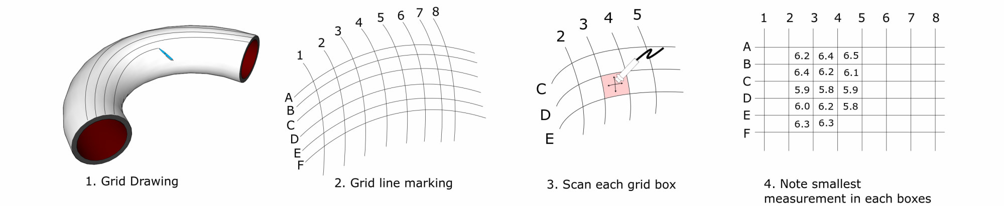

An inspector using a rigid PA probe to inspect pipes is forced to revert to the conventional UT technique and manually spot check each pipe elbow with a small-footprint transducer. This is a long process that entails drawing a grid on the elbow and verifying it box by box (Image 1). As well as being slow and tedious, this conventional UT method precludes inspectors from all the advantages that phased array technology offers.
IMAGE 1: The current inspection method for elbow corrosion mapping (Images courtesy of Olympus)

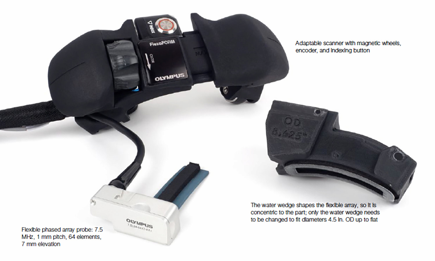

To resolve the inherent issues of pipe elbow inspection, a flexible ultrasonic phased array probe and scanner for pipe elbows can be used (Image 2). Using a flexible probe and scanner solution can provide high-resolution thickness mapping of the entire pipe elbow, making it easier for inspectors to make an accurate diagnosis.
IMAGE 2: Specially designed curved scanner for phased array pipe elbow inspection
With the precise information provided by the phased array mapping data, inspectors can evaluate the pipe elbow’s remaining operational life and determine the repair or maintenance requirements. Such a phased array solution is comprised of three components: a flexible phased array probe (for a wide range of pipe diameters), local-immersion water wedges, and a scanner that provides stability and positioning information in relation to the part’s surface.

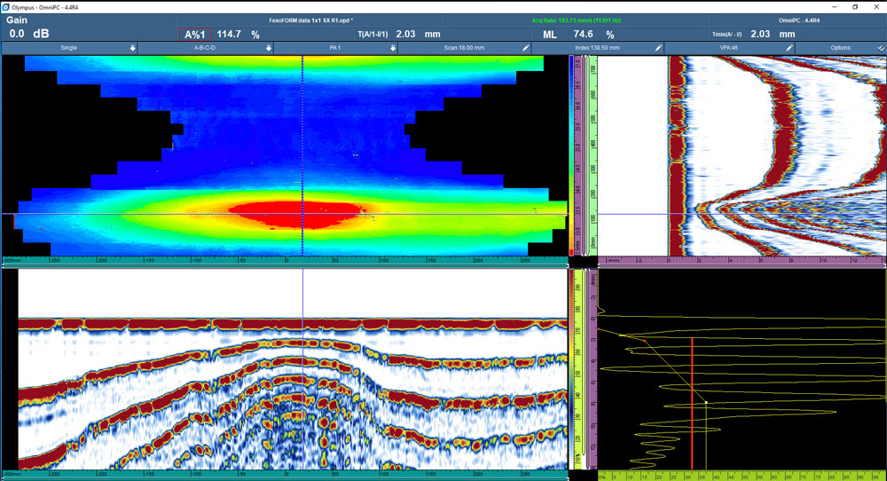

Another test was conducted on an 8.625-inch OD (219-mm), 7-mm thick, carbon steel pipe elbow. With a resolution of 1 by 1 mm using a beam aperture of three elements, the flexible phased array solution took only four minutes to scan the entire elbow.
Though the time savings are significant, the other advantage of PA is imaging. The scan results show severe wall loss. The different views (C-, B-, D- and A-scans) display the location of the erosion and its progression. The minimum measured thickness is close to 2 mm, which demonstrates the near-surface resolution that can be achieved (Image 5).
IMAGE 5: C-, B-, D- and A-scan views of flow-accelerated corrosion in a carbon steel pipe
