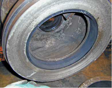

Consider the impeller shown in Figure 1 (below).
Impeller after incident
Figure 1. Impeller after incident

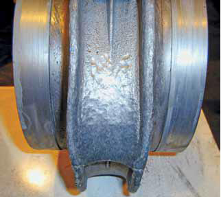

A foreign metal object entered the process stream and lodged itself inside the impeller. The event created very high vibrations and extreme impact loads on the wear rings. Fortunately, this pump was fitted with stationary composite wear rings as shown in Figure 2 (below).
Composite material case wear ring after incident
Figure 2. Composite material case wear ring after incident
The operators heard the noise, shut the pump down and put the spare pump into service without incident. The pump did not seize. No damage to the major pump components occurred except for the impeller, and hazardous product was not released to the atmosphere.
