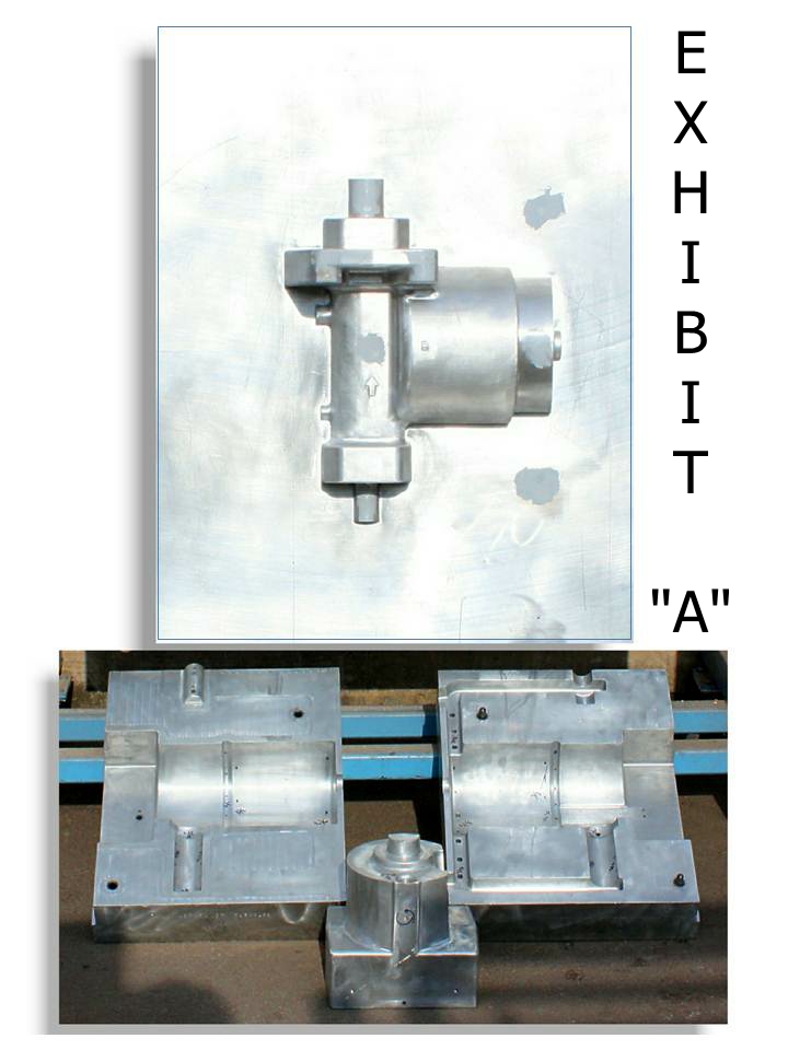

This example represents good tooling. The core will be manufactured in one piece
Figure 1. This example represents good tooling. The core will be manufactured in one piece (with no gluing or pasting) with excellent repeatability and on a competitive basis.
This is a good example of tooling currently in use with many manufacturers. It c
Figure 2. This is a good example of tooling currently in use with many manufacturers. It consists of wood, with loose pieces that must be manually glued and pasted together.  Dimensional stability is questionable. This casting's cost, with good tooling, would be reduced by more than 50 percent.
