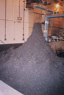

Grit is highly abrasive. Selecting pump materials of the correct construction and hardness is critical to ensure long pump wear life. For wastewater treatment plants, grit is typically defined as an “inorganic solid,” and it can be made up of sand, gravel, cinder, glass and other heavy inorganic material. The major abrading component of grit is silica sand. As a guide, the typical hardness of silica sand is in the Brinell harness number (BHN) range of 570 to 590. For water treatment plants, where the water source is a river, similar solids will enter the plant during higher river flow rates, which can increase water turbidity.
The amount of grit entering these plants varies. However, both facilities must remove it as soon as possible to alleviate erosive wear as the process water moves through the plant for treatment. Grit removal systems are provided in many different forms, and all require pumps for the disposal of the inorganic solids.
