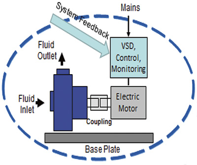

Europump, HI’s sister organization in the EU, first developed the term extended product (EP) to define the packaging of a pump, motor, driver and control technologies. Efforts continue on both sides of the Atlantic to develop the standards, data and labeling schemes that will guide the market-based adoption of this approach. Meetings between Europump, HI and other organizations continue in this regard. Potential energy savings achieved through optimized pumping systems exceed what can be achieved by redesigning and modestly improving pump efficiency. As documented in the DOE studies and pump system energy audits, pumps rarely operate at their best efficiency point for the specified head and flow. Figure 2 illustrates the concept of an EP with the pump, motor, driver and feedback/controls as a product package.
The EP concept with the pump, motor, driver and feedback/controls as a product packageFigure 2. The EP concept with the pump, motor, driver and feedback/controls as a product package
Energy saved by using the EP approach is significant. For the scope of products to which an EP approach on applications with variable load and low static head applies, HI estimated, based on the average load calculations, energy savings of 9.70 terawatt hours per year (TWhr/yr), compared to 1.90 TWhr/yr for pumps alone. Results assume the removal of 10 percent of the least efficient pumps (MEI approach) from the marketplace, as was carried out in the EU starting in 2013. When energy savings associated with the Minimum Efficiency Index (MEI) approach are combined with the EP approach, a potential energy savings of 11.60 TWhr/yr is possible. HI continues to pursue rulemaking that includes EPs, in which the greatest energy savings can be achieved. As a member of the EP Labeling Coalition, organized by the American Council for an Energy Efficient Economy (ACEEE), HI is working with other members, including National Electrical Manufacturers Association (NEMA), the Air Movement and Control Association (AMCA) Compressed Air and Gas Institute (CAGI) and the Fluid Sealing Association (FSA) in advancing market approaches that can support utility-based rebates and incentives to stimulate market demand and eventually optimize pump systems. The first meeting of this group was hosted in December 2013 by the Northwest Energy Efficiency Alliance (NEEA).
