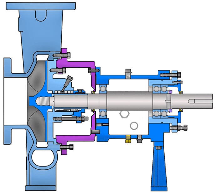

Horizontal end suction centrifugal pumps are undoubtedly the most common pumps in use in the world today, yet I witness basic misunderstanding of the pump specification almost every day. I thought it might make for an informative and fun quiz to go over some of the more misunderstood sections of ASME/ANSI specification B73.1 (2012).
Figure 1. Example of a pump designed to fit the ASME/ANSI B73.1 (2012) specification. (Courtesy of the author.)
As an editorial comment solely on my part, the ANSI pump geometric design parameters are based on old technology. The original designs were based on pumps and applications with packed boxes and lower energy levels. Today, the basic ANSI pump design is shackled with high shaft deflection ratios, low efficiencies and inadequate seal chamber options. Some of these deficiencies can be addressed with options and auxiliary systems, but pump manufacturers and end users probably wish we could start the design over with a new blank sheet of paper. Who is going to tackle this problem?
