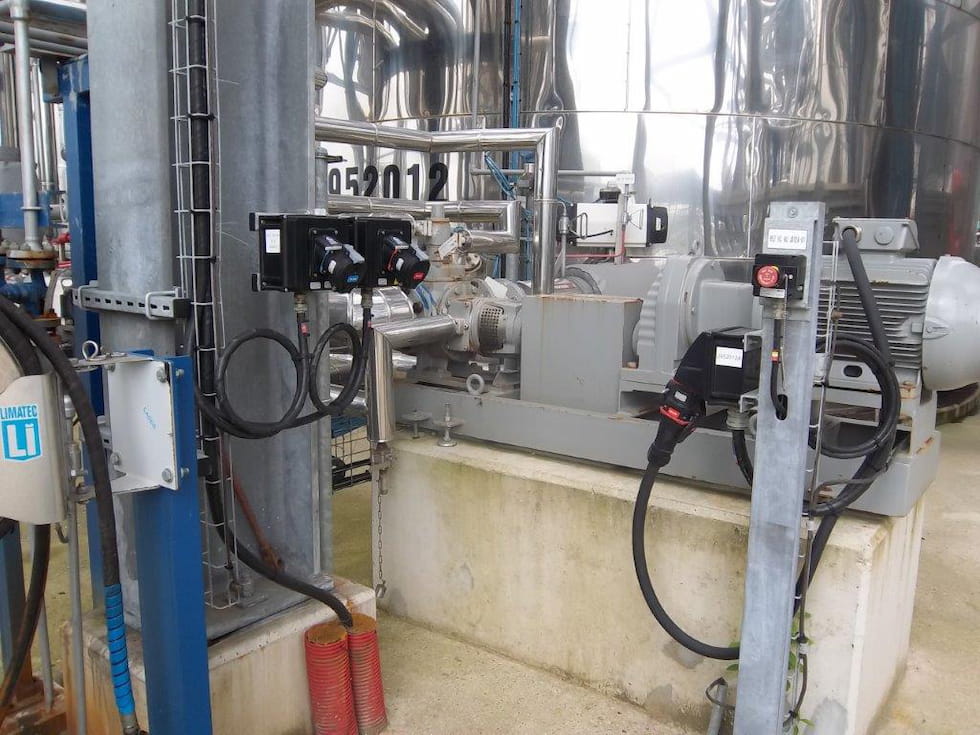

Opening a traditional disconnecting device to visually verify that all phases are opened comes with its own dangers, as it requires the worker to become exposed to bare, live conductors. This is why NFPA 70E Article 130 requires an electrically qualified worker to perform the operation. Additionally, the electrically qualified worker should implement proper PPE as per Article 130.
The only way to get around this is to use a disconnecting device where the worker can visually verify that all blades of the disconnecting device have disengaged without becoming exposed to bare, live conductors. Provided a worker is only operating a switch with the door closed, the operation is considered a normal operation.
Qualified workers and PPE are not required for a normal operation because an arc flash event is unlikely to occur, as per Table 130.5(C) of the NFPA 70E Standard.
