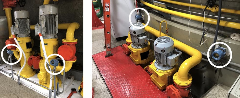

Case Study 1: Hybrid Switch & Transmitter on Lubrication Oil Pumps
Application challenge
In one plant of a major industrial end user in South America, some of the mechanical switches installed on pumps for the lubrication oil system were old and out of service, posing a few challenges to the instrumentation team. First, the process variable was hard to verify, as there was no display on the switches and the line gauges were located in hard-to-reach areas. Second, significant maintenance time was spent on the switches—about one hour of maintenance per switch—with at least two maintenance cycles per year.
Solution
The user replaced 24 mechanical switches with a shutdown hybrid switch and transmitter. The hybrid technology was chosen to ensure that when the oil pressure fell below the 32 pounds per square inch (psi) setpoint, the backup lubrication oil system would kick in to avoid any lapse in oil flowing through the turbine system. The hybrid instrumentation technology enabled the pump operator to:
- Program setpoints and deadband locally on the device, which simplified setup, calibration and maintenance of the instrumentation
- Derive device diagnostics to verify the instrumentation was working optimally, reducing service maintenance time
- Exercise the option of extracting the 4-20 mA output to trend pump process data and develop a predictive pump maintenance program in the future
