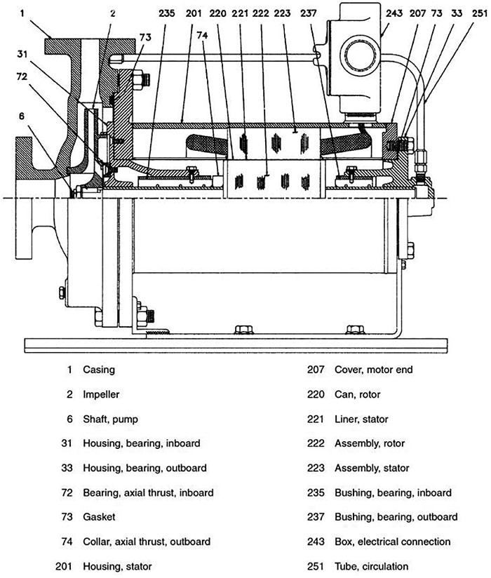

Q. What are the advantages and limitations of a sealless pump design? A. A sealless pump is used when there is a need to contain toxic, dangerous and/or valuable fluids. Application may be dictated by space, noise, environment or safety regulations. This section outlines types, nomenclatures and components of sealless rotodynamic-type pumps. Sealless pump design is founded on eliminating the dynamic shaft seal between the wetted end of a centrifugal pump and the atmosphere. This is achieved by enclosing the pump and its rotor assembly inside a pressure vessel with the pumped fluid. The pressure vessel or "primary containment" is sealed by static seals, such as gaskets or O-rings. The inner rotor assembly is driven by a rotating magnetic field that is transmitted through a containment barrier. Sealless pumps fall into two categories: magnetic driven pump (MDP) and canned motor pump (CMP), as shown in Figures 5.1.3.1 and 5.1.2.1.
![Figure 5.1.3.1. Magnetic drive pump: separately coupled (closed or semi-open impeller)](/sites/default/files/1115/Figure-5-1-3-1-Magnetic-drive-pump.jpg)
![Figure 5.1.2.1. Canned motor pump: close-coupled, end suction, overhung impeller](/sites/default/files/1115/Figure-5-1-2-1-Canned-motor-pumps.jpg)
