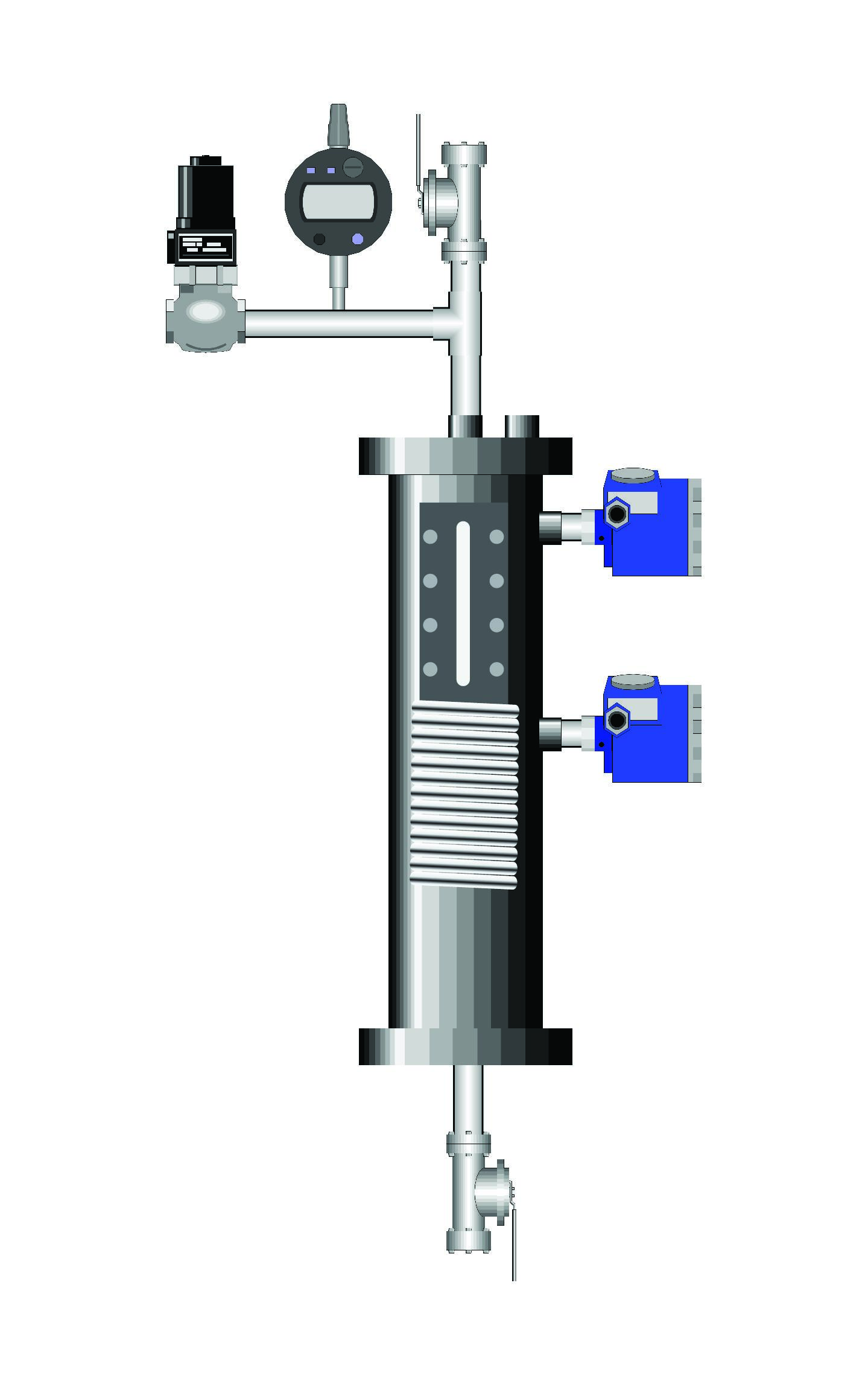

Pumping systems involving toxic, hazardous or corrosive fluids cannot allow leaks into the environment. In such cases, a pump may have a double or tandem seal that uses a compatible liquid injected into a seal chamber to serve as a barrier fluid.
If any hazardous product leaks across the inner or primary seal, it enters the seal chamber and mixes with the barrier fluid. Improper control and maintenance of the seal environment can result in total seal failure, along with unsafe leakage of undesirable products into the environment.
Supply tanks—called seal pots—serve as a reservoir of clean, pressurized barrier fluid for double or tandem seal assemblies (see Figure 2). Fluid loss would result in catastrophic failure of the seal and dangerous conditions.
Therefore, operators must know if the fluid level drops too low, indicating a fluid loss problem. These seal pots generally have either a high-level or low-level liquid switch, or both, depending on the application.
The low-level switch indicates a loss of barrier fluid, while the high-level switch indicates hazardous product leakage across the primary seal and into the seal chamber, which adds fluid volume and raises the seal pot level. Outputs from these switches connect to alarms or the plant control system, calling for immediate corrective action. All seal pots use a pressure sensor, with some systems requiring a pressure switch to activate an alarm or to shut down the pump for added safety.
Figure 2. Seal pots containing barrier fluid typically are monitored via a pressure gage, a high-level switch and a low-level switch.

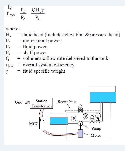

Many pump performance monitoring approaches use sensors for suction pressure, discharge pressure, flow rate, pump speed and power use. From these variables and other details, the efficiency and condition of a pump can be determined.
Pump efficiency is defined as the pump’s fluid power divided by the input shaft power and is influenced by hydraulic effects, mechanical losses and internal leakage. The calculations involved are shown in the sidebar, “Calculating System Efficiency.”
The system efficiency, as designed by the power transfer in and out of the diagram in Figure 4, is:
Figure 4. System efficiency
The flow rate is the net flow between tanks (ignoring recirculation flow). The head is the elevation difference between the tanks, or static head (implicitly ignoring friction losses). This is true system efficiency—it overlooks the details and sees only the big picture. This approach can be quite useful. However, it does not work for all situations. For example, the equation will produce a system efficiency of zero for a closed-cycle circulating system (with no static head).
