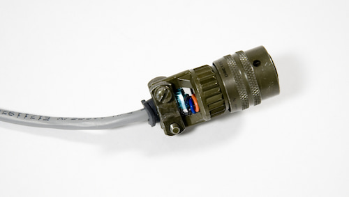

The blue shield foil can be seen here, tucked under the cable connector. This is important to properly shield the cable from electrical noise.

It is assumed that all cabling is shielded with either a braided or foil shield surrounding the bundle of wires inside the cable. A single drain wire running through the wire bundle will be insufficient if there is no shielding in the cable.

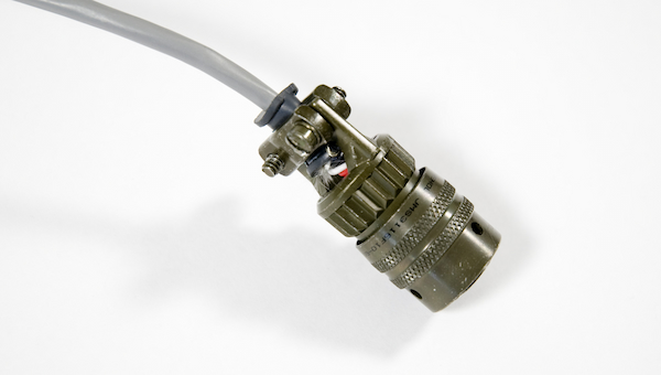

The drain or ground wire typically runs next to the shield and can be used as a connection point to the cable shielding. The shielding protects the wires inside from being exposed to EMI from radiated noise. Radiated noise is generated from any wireless electronic device.
EMI from radiated noise will be nearly impossible to block without a shielded cable. The noise will be induced onto the wires and run right into the sensor or instrumentation. The only way to avoid this is to always use shielded cable.
The ground wire inside the cable is pulled out and tucked under the cable connection. This connects the ground to the sensor.

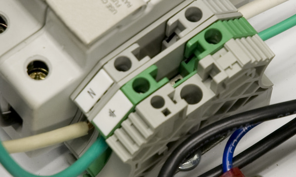

The green ground wire is seen here inside the wiring panel.
If the cable shield is tied to the transducer case, the easiest method is to simply not connect the cable shield to the ground terminal of the wiring box. Many end users have a hard time with the idea of a floating wire, particularly a ground. Just keep in mind that it is actually grounded, just on the other end. Some end users choose to cut the ground wire off the cable or tape it down. Either of these is an acceptable option.
If the transducer case and cable shield grounds are disconnected, then the cable shield should be tied to the terminal ground in the wiring panel. If neither of these is connected to a ground, then the cable shield will be “floating” and offer no protection at all against EMI. A floating cable shield is a great way to create noisy signals and have many problems.
