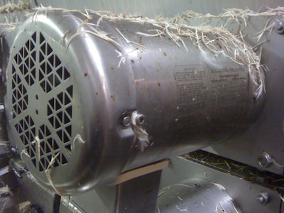

Stainless motor used on a feather picking machine
Knowing that a motor would form condensate inside the frame after it was shut down, weep holes were added to the endplates on each end so the condensation could exit the motor at its lowest point. The inside of the motor was treated as if it were going to get wet from condensation and encounter possible leakage. These first motors had a double dip and bake of epoxy varnish on the windings with an extra slurry for protection on the end turns.

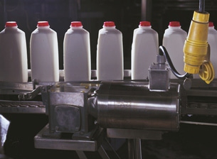

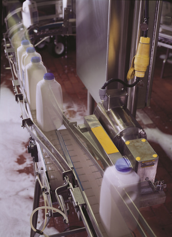

Milk production line driven by stainless motor and gearbox
All-stainless endplates and conduit boxes were tooled and a stainless steel band was supplied. The conduit box was sometimes welded to the band to eliminate a point of leakage. O-rings were used at the joints between the frame and endplates. To further protect the winding, it was encapsulated in epoxy, which was allowed to run into the conduit box and form a seal. Upgraded shaft sealing was supplied, often with a labyrinth seal. To avoid food becoming trapped under the nameplate, the nameplate data was laser-etched onto the surface of the motor housing. These all-stainless motors now had the finish to hold up to the higher hose down pressures and cleaning solutions.

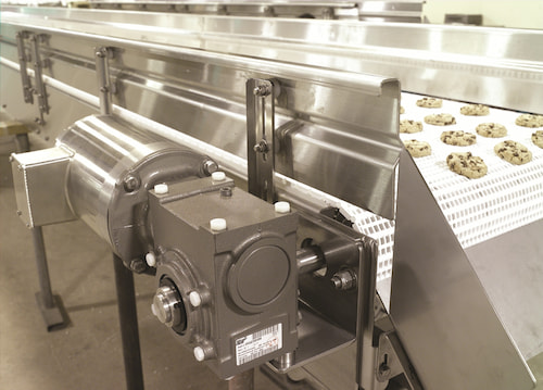

Stainless motor driving a conveyor for cookie production
