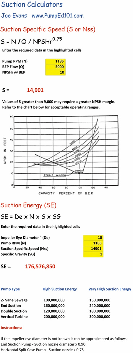

An Excel-based Suction Specific Speed calculator is shown to the left of Figure 1 and is available for download from my website. Entering the required data in the three yellow cells will result in the calculation of S. The chart below the calculator shows the stable window of operation for several values of S. Normally, suction recirculation occurs at low flows, but with increasing values of S, suction recirculation will begin at higher than expected flow rates. Many experts specify that pumps with a value of S greater than 9,000 may require a sizeable increase in NPSH margin if they are to maintain a stable window of operation.

The SE calculator appears to the right of Figure 1. Entering the required data in the highlighted cells will result in the calculation on SE. The table below the calculator shows the values for the start of high and very high suction energy for several pump designs. Pumps that exhibit a high SE can experience vibration, noise and minor cavitation damage. Those with an extremely high SE can experience more severe erosion due to cavitation.
The example used in both calculators is a dry pit non-clog with a 12 in suction and a two vane, 18.5 in impeller. BEP flow is 5,000 gpm @ 105 ft and requires a NPSH of 10 ft. Both calculators confirm very high values of S and SE, which indicate that a large NPSH margin is required for this pump to operate at off BEP flows.
