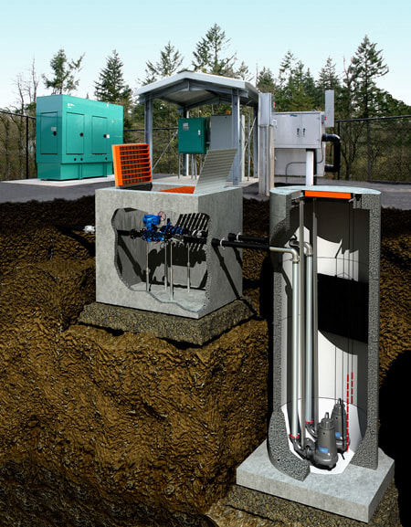

Submersible Pump Systems: Municipal Favorites
Camas, Wash., is a town of 17,000 outside the Portland, Ore., metro area. To serve its growing population, the city's Public Works department has an aggressive program to update existing sewer infrastructure. In the last few years, Camas has replaced five wastewater pump stations and brought an equal number of new stations online.
All of the city's legacy pumping systems have been replaced with pre-engineered submersible pump lift stations. The submersible system consists of the underground wet well, equipped with submersible pumps, piping and liquid level sensors; the valve vault; the force main; the above-ground electrical control panel and a standby electrical generator.
Submersible lift stations are the dominant pumping system in the municipal market. They offer lower initial cost because only one pit is needed (compared to traditional dry pit-wet well installations). The stations generally have a smaller footprint, low operating cost and simplified operation and maintenance. Because the only above-ground structures are the control panel and backup generator, submersible pump lift stations tend to blend in with the surrounding environment-a plus for public relations.
Submersible wastewater pumps are vertical, direct-coupled, heavy duty centrifugal units, which operate underwater. The pumps offer high operating efficiencies. Most municipal lift stations require pumps that will pass a 2.25 in diameter sphere without clogging and have a minimum 3 in diameter discharge. Rather than using a single pump, most systems have multiple pumps in a duplex (two) or triplex (three) pump configuration. This provides redundancy, in case of a pump failure or clog.
Camas worked with a pump station manufacturer to procure complete sewage pumping systems with all components--structural, mechanical, electrical and communication--in one shipment, pretested and ready to install.
The complete systems, configured to meet Camas' requirements, allow the city to standardize its lift station network. "The stations are all very similar, and that allows our maintenance folks to work on them easily," explains Jim Hodges, the city's Capital Projects Manager. "They don't have to learn different telemetry for different stations. . . the same is true for the pumps."

Duplex submersible pump station
