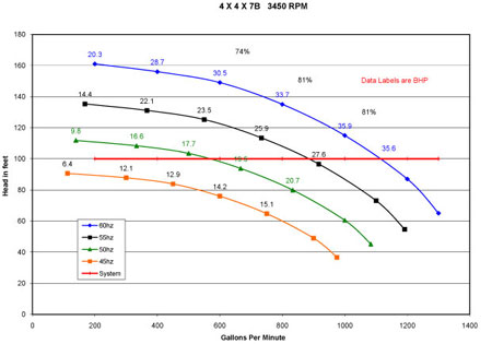

Figure 2 shows a pump under consideration for a constant pressure application that requires flows of 500- to 1,100-gpm at a boost of 100-ft. Although there will be some periods with flows of 1,000- to 1,100-gpm, typical flows will fall in the 600- to 900-gpm range.
How well does this pump meet the requirements we have discussed? The curve exhibits a rise of about 54- ft (54 percent) from 1,100- to 500-gpm, so control is optimized and power savings should be significant. BEP efficiency is excellent at 82 percent. The maximum flow point is 122 percent of BEP flow, which is well below manufacturer-approved flow, and efficiency is a healthy 78 percent. This allows us to place BEP flow in the area where typical flow occurs. The efficiency at the low flow point is just 66 percent, but it improves significantly under VFD control. Overall, this pump appears to be a good candidate. All that remains is to review its actual performance.
Figure 3 shows the actual performance by plotting the variable frequency curves against the system curve. The points at which the frequency curves intersect the system curve will be the flow point for that frequency. The control range is approximately 49- to 60-hz (12-hz) over the entire range of flow. Even at a relatively low resolution of 1/10 hertz, there will be 110 individual operating points.
As illustrated by the 60-hz, 55-hz and 50-hz curves, the three major efficiency points move to the left as frequency is reduced. This results in a minimum efficiency of 80 percent for flows between 650- and 1,000-gpm. The absolute minimum efficiency occurs at 500-gpm, but is increased to 74 percent due to the leftward migration of the 600-gpm/60-hz point. The efficiency is 78 percent at maximum flow, and the average efficiency across the entire flow range is 79 percent. As shown by the data labels, these high efficiencies result in a substantial power savings compared with PRV control. For example, at a midrange flow of 800-gpm, the BHP required is 24.9 at 53-hz versus 33.7 at 60-hz.
