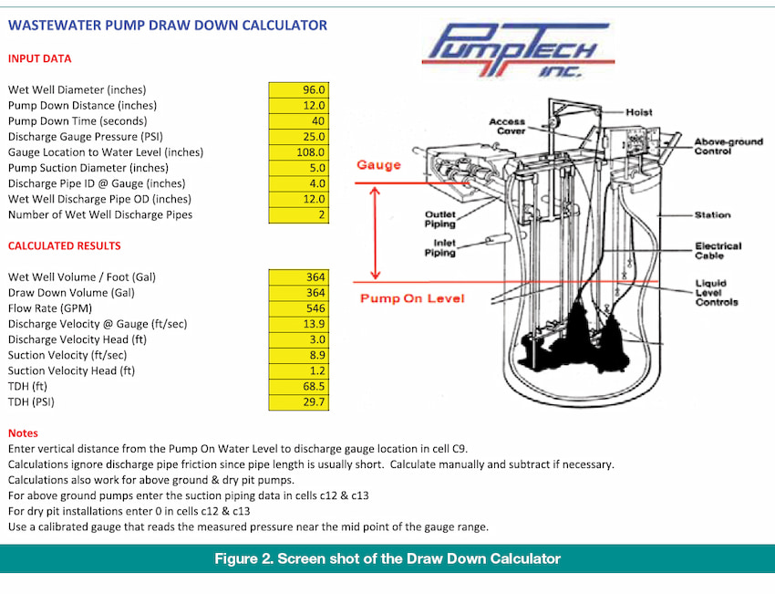

The Draw Down Calculator
Figure 2. Screen shot of the Draw Down Calculator
Figure 2 is a screen shot of my Draw Down Calculator, which is available as an Excel spread sheet on the “Pump Sizing, Selection & Testing Tools” page at www.PumpEd101.com. It provides a standard procedure for testing wastewater pumps when a flow meter is not available. The calculations take into account the elevation difference between the pump start water level and the gauge position.
The calculator also includes the suction and discharge velocity heads in the total dynamic head (TDH) calculation. If the wet well contains submersible or above ground pumps, the wet well volume per foot can be corrected for empty discharge or suction piping in the wet well.
This can increase draw down accuracy in smaller wet wells. Testing wastewater pumps at least twice per year will reveal changes in operating conditions due to changes in system conditions and pump wear. It will also alert end users of potentially damaging off BEP operation.
